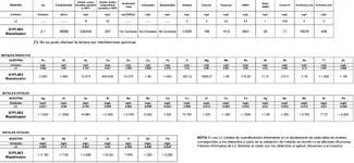

We pay some studies and find the following results (attached)
As reference
Au: 2 mg/liter
Sulphates: 55000 mg/liter
Fe2+: 10216 mg/liter
PH: 2.1
The easy maths are taking about almost 3Mu$s in leached gold per year. Obviously I don´t know if it´s possible to take it, so here I´am!
