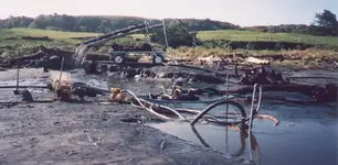

Also I want to make a new high-banker for the beach.... I have the mats just have to go get the ABS.
Please dont take the tractor down to the beach, Thats why were OVER REGULATED as is, STUPIDITY. Being subtle is the best choice i think. johnnysau

Humor can easily be missed........:icon_scratch:
Now as far as tractors.... I can think of a number of places I WOULD like to run a tractor through......:laughing7:.... just think about that one minute or two.....:laughing7:
