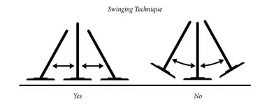

Hi sannich,
Yes, you'll get more comfortable over time. You don't want to actually have it touch the ground (this will cause false signals), but shoot for about an inch. As you swing, work at not swinging in an upward arc when you get to the end of your swing; straight and level for the whole arc:
Here's a link to the MineLab blog with some other tips:
https://www.minelab.com/go-minelabb...echniques-how-to-get-the-most-from-your-sites
Have fun, keep asking, and keep swinging!
