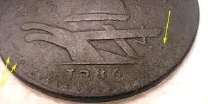

That is a nice NJ copper, yes as stated it is a Maris 17-J. The latest rarity I have on the variety has it down a notch to a R-4 (Very Scarce), I do have a NJ collector coming to my place later this month and I will see if there is another updated rarity list, but the one I have from a few years ago and the website Coinfacts, lists it R-4. With that said, take a very close look and see if you can tell if it might have been struck over another colonial, like a Conn copper. I have a photo of one in a C4 auction catalog from 2007 that is overstruck on a Conn copper. That coin sold for $200, and not sure if it were a grounder or not, but grounders with corrosion are almost always lower in price unless it is really rare. It does appear to be a bit funk in the lower left denticle area on the plow side and also just past and below the plow on the right appears to show evidence of a undertype.
I have been doing a distribution study of ground found NJ coppers for quite a few years now, and this would be the 3rd Maris 17-J in the survey. The other two being found in central southern NJ.
It would be a total waste to send the coin away for slabbing, if you intend to ever sell it, just put it on ebay as is and yes say it is a Maris 17-J variety. Almost all colonial coin collectors despise slabs by the way....
Since you soaked it in oil, the only further cleaning you can do is what you have done, so as Iron Patch has said, stop now or go ahead and try more time for that crud on the reverse, but without seeing the coin in person, cannot really say if furhter soaking will help or not or hurt. If you do try further, I would go carefully with a toothpick on the crud areas and see what happens.
