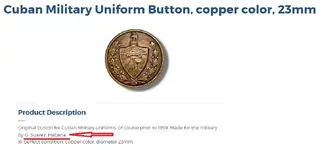

I've located one reference that identifies G. Suarez as a maker of Cuban military button.

According to the book "American Military Button Makers And Dealers; Their Backmarks & Dates", the Suarez backmarked buttons were made by the Waterbury Button Company, in the very-late 1800s and a bit later. The book also indicates this was a case of a button-maker using "leftover" button backs with an incorrect backmark. Suarez was a uniform maker, not a button maker. The info-source you found is incorrect about that. It's a common mistake among people who haven't read the backmark book... they assume the backmark tells who made the button. In a few cases, that's true, but in most cases, it's false.
Thanks much! This is what my 'gut' was telling me. Like the "Cuban" cigar, they must have had a uniform industry that exported, and the U.S. represented a large market. Your explanation of back marks stating the clothier is one I've seen before in dug buttons. I have but one reference by Albert, so I appreciate your work in the book you cited; it helps narrow down the date of issue.
