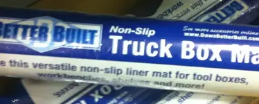

The jack aisle has those truck boxes and on the bottom shelf I noticed this
The texture seems the same as the easyline if someone wanted blue.
Shop Better Built Truck Box Mat at Lowes.com
