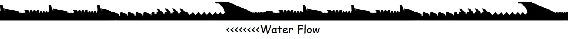

I am about to build a 60" x 12" x 4" X 0.80 Sluice using Gold Hog Mats. The Sluice will sit under my 12" trommel and will be fed by shovel or 5 gallon buckets. Will be using a pump that can deliver nearly 8000 GPH. Please take a look at the image. I had contacted Doc at Gold Hog and he suggested the configuration in the image below. At the end of the Sluice will be a Fluid Bed Gold Trap. The material that we are digging can range from flake gold to 1/4" diameter gold. The trommel will be classifying to 1/2" before dumping into the Sluice. I would like some input from those who are using the Gold Hog Mats, your thoughts, idea's, what your using, how your using the mats, etc. Thank You In Advance

Have 2 sluices now that use GH mats. Love em. First is a Keene A51a and the second is a 36" x 12" x 4". The second can be used as a highbanker as well. The configuration you show looks good. I use a similar setup when the 36" sluice is setup as a highbanker.

I like it... but then again I'm prejudiced.... :laughing7:
I'll add a couple of notes....
When putting in a new matting config you should start off by taping only.
This allows you to adjust if needed.
Do a test and get to your ideal capture / loss % whatever that may be.
Try and get your water depth about 3/4" - 1" on this config.
Try different pitches, but my GUESS is going to be 7-8 degrees. (Digital angle indicator really helps in the field.)
This config does really well in assisting with settling velocities.

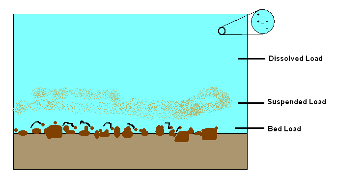

The Scrubber gently lifts the BED LOAD without creating much turbulence.
It also has enough downward pull / low pressure zones / vortexes to draw down the SEDIMENT LOAD which contains most of your VERY fine gold.
As it drops / settles... gold and black sand will drop out first.
So it has to go over the rest of the scrubber and razorback before being lifted again.
I would LOVE to see one strip of very low cut down RiverHog about halfway down, but it's not necessary.
That one strip battles ANY floating gold which is more a factor in very dry environments.
Remember... there are really only 3 ways to reduce surface tension and stop any floating gold.
1- Temperature. Hot water has a lower surface tension. (Not an option for mining though.)
2- Surfactant - such as soap or jet dry. (Not really an option for mining large scale.)
3- Turbulance - If you break the CALM water surface with turbulence, it will destroy almost all the surface tension / greatly reduce it at that point.
That's why on our Viper and Monster we put in a few strips of Riverhog about half way down.
Hope that helps...

Found this pic to also help...
Sediment and Suspended are the same.
