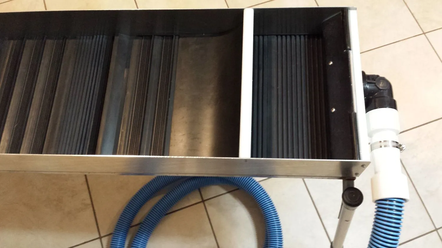

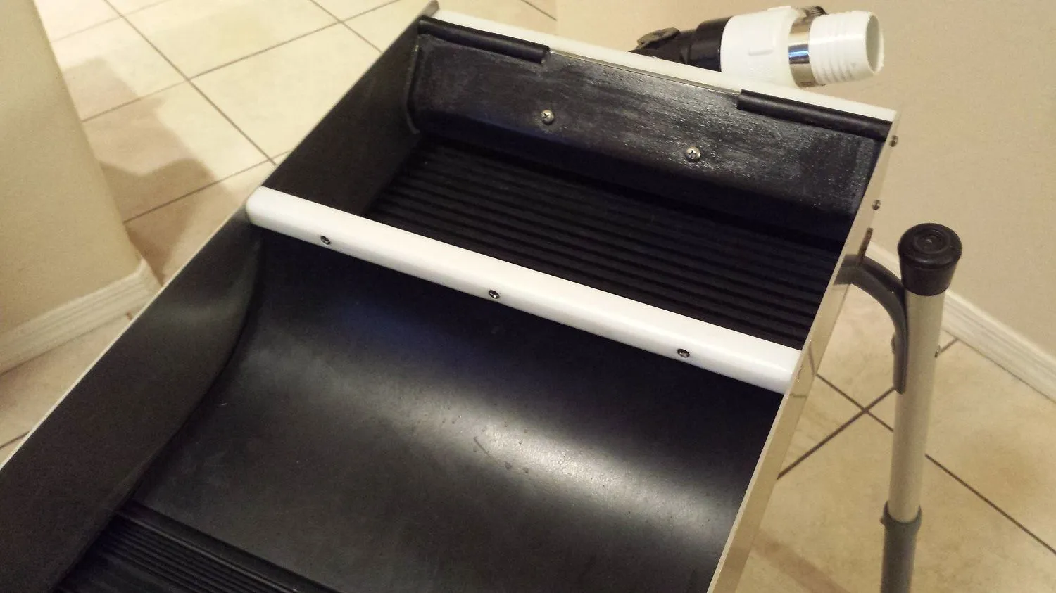

I am about to build a 60" x 12" x 4" X 0.80 Sluice using Gold Hog Mats. The Sluice will sit under my 12" trommel and will be fed by shovel or 5 gallon buckets. Will be using a pump that can deliver nearly 8000 GPH. Please take a look at the image. I had contacted Doc at Gold Hog and he suggested the configuration in the image below. At the end of the Sluice will be a Fluid Bed Gold Trap. The material that we are digging can range from flake gold to 1/4" diameter gold. The trommel will be classifying to 1/2" before dumping into the Sluice. I would like some input from those who are using the Gold Hog Mats, your thoughts, idea's, what your using, how your using the mats, etc. Thank You In Advance

i agree with Good Guy, i need to watch the material dane behind the riffles to know if its the right angle and water flow. BUT it looks real good as is!
Hi AZ.........
Sorry, had to deal with "sewage problems" at the house for several days.
Main line collapsed between the house and septic tank.
Man........ it sure is nice to be back to normal again.
Both videos look pretty good, but a capture rate test will be need to make sure.
My only concern is that we are "air pocketing" on the RiverHog sections a bit due to the water depth.
We might have to trim that riffle down just a bit more, or add more water depth if that is an option.
However... often when you add REAL / RAW dirt to the slurry those settle down and become smooth.
It's amazing how a muddy slurry changes the flow.
When you run it, you'll see what I mean.
This applies to both highbankers and dredges. The flow changes dramatically sometimes.
Now...
Not sure if you watch Gold Rush at all, but a good example of IMPACTION is Parker's sluice.
Lack of VERY active exchange, with lots of heavies, often leads to impaction and allows gold to ride down the sluice.
So, that is why I encourage people (and ops) to go to the extreme... then tone it down.
Most people do the opposite. They start medium velocity... see they are losing gold... then think they need to slow it down.
That only makes it worse.
Start off running it TOO FAST... then test.
If losing gold, tone down a LITTLE. Test again.
You want it to run as fast as possible with a capture rate that is within your total satisfaction.
This will keep capture zones open for gold for long and heavy runs.
Winter is a GREAT time to test and get it dialed in.
Once you get it dialed in... you're done.
Shout if you have any more questions.
Doc

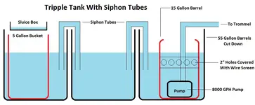

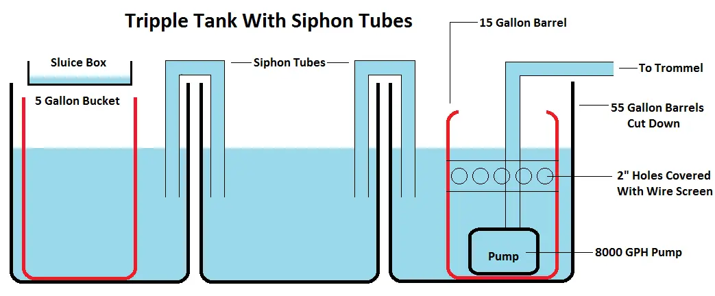

I believe page 7 on my trommel build I address the issues on my water system with a drawing, but here it is again...
In building my triple tank to recirculate water for my Trommel / Sluice it’s important I keep the water going into the spray bar free of debris. The idea to draw the water into the inner 15 gallon barrel through the two inch holes below the water line so it’s free of floating leaves, sticks, etc. These twelve 2" holes will be drilled around the circumference of the barrel and will be covers with a removable screen that slides over the barrel. The 15 gallon barrel needs to be taller so water does not flow over the top into the inner barrel. The 4" siphon tubes need to draw the water from the middle of the barrels as well so it’s away from the floating debris. The 5 gallon bucket under the Sluice Box will collect the dirt and rock that’s discharged from the Sluice. At the end of the discharge end of the Trommel will be a wheel barrel to haul the 1/2” and bigger rock to dump. It will all be checked with a MD for larger gold than 1/2".
We will be running a generator to power the pump of which we will use a GFIC outlet to be on the safe side. As for that flat hose that's for testing only. I have a roll of 1-1/2" pool vacuum hose that has a smooth ID that will be used.

I remember seeing that pic now of tank. I only mentioned it because I know I need to rethink how my recirc works for my system. I'd like to get it so my dirty water stays in tub and cleaner water runs through the pump. That way it doesn't seem like a milkshake running over sluice. Possibly pushing gold out.
We have been running the triple tank like in the drawing on another sluice box. It works great as the pump is being feed from water about mid level of the water line so everything that floats will not be drawn into the pump. The same thing for the siphon hoses they are drawing from mid level of the water line in each of the other two tanks. The bucket under the sluice will be a cut down 15 gallon barrel that will be changed out as it becomes nearly full. We also use a swimming pool skimmer to skim the tank to keep most of the crap that floats out.
Were ya a pool guy at some point? Cuz I've got some of the same stuff which I then use for this as well. So now I guess I should get a bigger tank and go three stage. I tried to do separate totes but couldn't get siphon part to work properly.
Never have been a pool guy. Although have wired and installed many pool pumps over the years. I am one that will tackle anything and everything. I hate to pay anyone to do a job I can do and do a better job considering the work force that's on the job today. I know that's a rather bold statement on my part but I am skilled in many trades. I was taught a very good lesson from a friends father when I was maybe 10 years old. His dad owned a car auto repair shop, back when cars had a distributor, points, rotor, cab. This a**hole would pull the spark plugs and bead blast the plugs, file the points, wipe clean the distributor cap and clean the contacts, file and clean the contact on the rotor and reinstall the old parts. When the customer showed up to pick up their vehicle he would bring these new/old boxes and say to the customer, "do you want the boxes from the new parts". This lesson had a lasting impression on me and to this day I do not trust anyone to do anything for me.
You need to be using large diameter pipe so that you do not drain your first tank dry. We use 3" cheap white irrigation pipe from HD. If your using three tanks you will need 4 elbows and 4 pipes. I would not make the pipes so long that your picking up the crap from the bottom of the tanks. Remember its better to oversize the pipes than be undersized. Once you shut your pump down the siphon pipes will balance the water within the tanks then stop flowing between tanks until you start your pump up again. To plug the 3" pipe to start the siphon use a rubber ball from the pet store. Once you have the pipe submerged under water plug one end of the pipe. Quickly place the pipe over the two tanks as seen in the drawing and remove the ball, the flow of water will begin between the two tanks until the water level is balance. If you have anymore questions PM me..
