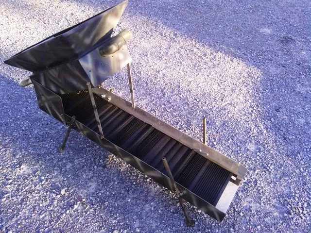

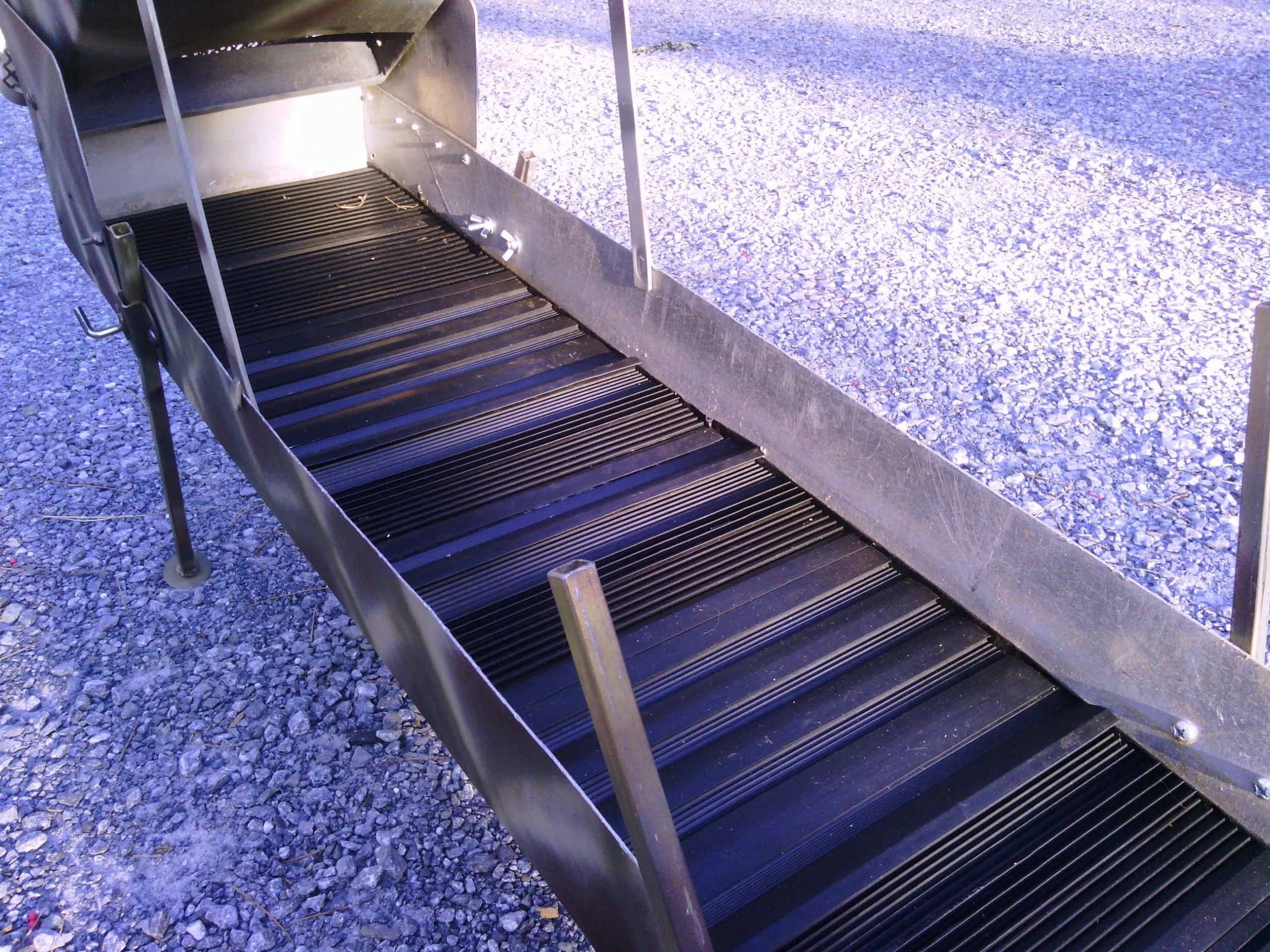

I have them in my new power-sluice .We have only ran 30 buckets through it. We were pre classifying because we didn't have a pump so no spray bar. We had to carry material to it any ways I'm ok with less yet heavier buckets. The increase amount of superfine gold we captured compared to what my drop riffle captures was ridiculous. Though I have never ran that much material through any sluice on our claim. so far pretty sweet. I have ur-ur-bedrock-scrubber- scrbbr- bedrock-scrbbr-ur. There was no razorback when I bought them at PLACERVILLE HARDWARE.. I might pick some up and switch it up. It was clearing awesome and the material was dancing beautifully so could see the exchange it is pretty cool. GOOD STUFF DOC:headbang:
