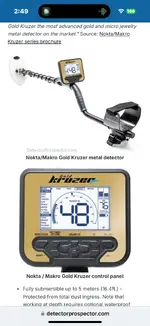

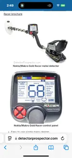

Ive had both the gold racer and gold kruzer. the gold kruzer is waterproof and made better and quite frankly WAY better than a monster 1000. (i know some will disagree about the monster but with my first hand experience i can tell you the monster is nowhere near the gold kruzer in performance or quality.) the gold kruzer is not bump sensitive at all. where as a thick blade of grass will set off the monster. handles hot ground 1000 times better and it hits just as hard on tiny gold if not better. oh yeah and its half the price. ive found at least 1000 pieces of gold with it from fly poop up to 20 gram nuggets. Mine is a few years old and all scratched and scuffed up, dirty and been dropped plenty of times in the goldfields. still works perfectly. im not brand biased at all. I have a couple minelabs that i like a lot and a Garret axiom is my newest toy. I have not tried it a saltwater beach so i cant say anything about that but as far as prospecting for tiny gold you cant go wrong with it. it is not a gold racer...totally different machine
Really? Because the interface and settings appear to be very very similar. Also it was the same company. GR was cheaply made in my opinion.
they have similar interface and setting and they are the same company. there are some big differences. gold racer is 56 khz, gold kruzer is 61 khz.(different engine) gold kruzer is built fully waterproof where as the gold racer is not.(kruzer is better build quality) gold racer had the headphone jack and battery under the armcuff. ( headphone jack was the only thing that failed on my gold racer), gold kruzer has all the electronics in the waterproof head unit and nothing under the armcuff. the coils are different and not interchangable. so yeah the screen is similar but thats about it. just because you have to run the gain lower in high mineralized ground does not mean your detector is inferior to some other guys detector in a different location. that goes every detector ever made. soil means everything when it comes to adjusting settings and filters on a metal detector.
I assumed same guts put into a better “box” by the same company.
I see the differences and I’ve been tempted to do that upgrade.
