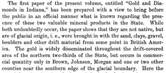

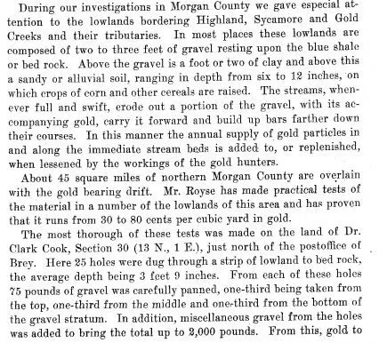

Not sure what's been posted concerning gold in Indiana but I came across this in an early geological report.
my aunt and uncle live in Gnawbone for many years. That's in Brown County. Back in the 60s and 70s I recall them talking about gold prospecting in the area. They spoke of small diamonds also.
I think back at the turn of the century like the article speaks of, it was not uncommon for folks to be trying creeks for color.

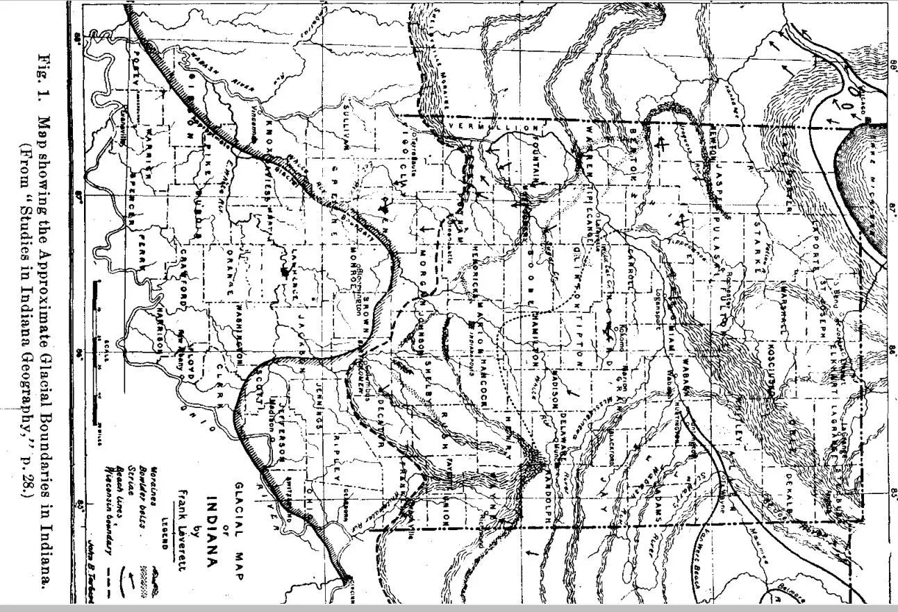

dognose - found a map that shows where the glaciers stopped. Looks like the southeast part of Owen would be a good area to look for gold and diamonds.
Owen Co would be on the southern edge, as mentioned in this article.

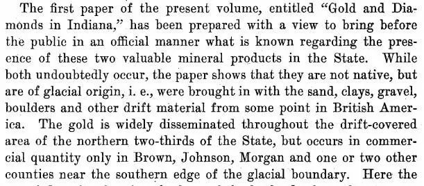

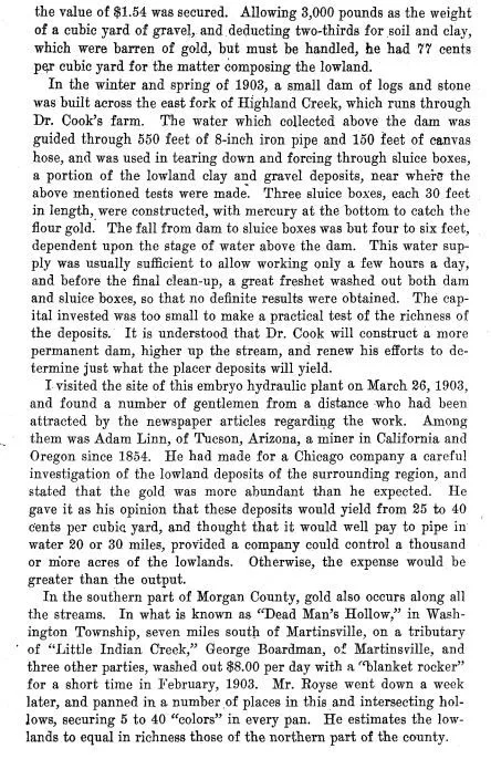

If you want more information, there was a good paper presented in 1902 on the subject of gold and diamonds in Indiana.
This was just the introduction. Article is quite detailed and lengthy (too long to post here). I found it on-line.

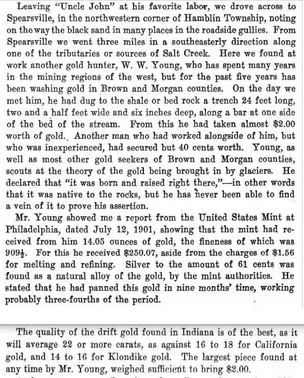

Took this from the same reference as the map previously posted. I was surprised by the quality of the gold found in Brown & Morgan Counties.
That 14.05 ounces Mr. Young sent to the mint, today would be close to $25,000.
