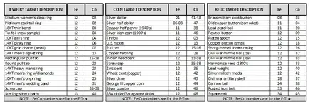

Here's an FE/CO chart for help identifying your targets.....
