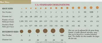

According to the US Ordnance Manual of 1861, grapeshot balls ranged in size from 2.02" to 3.60"-diameter. So, if a ball is smaller than 2-inches, it is not a grapeshot ball.
As the "US Standard Sizes" chart for [bird]shot and buckshot shows, buckshot balls range from .25" to .36"-diameter.
Great chart.
I believe my original post rules out Grapeshot. The "grapeshot" may have been more due to obvious NOT ROUNDED lead items that were packed tightly among smaller ROUNDED lead items....IE like Grapeshot.
