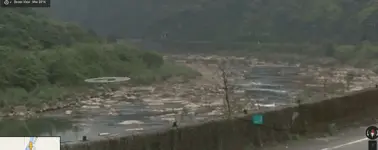

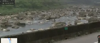

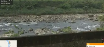

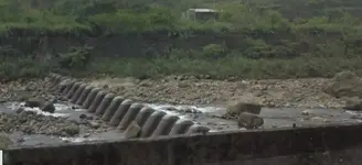

Hi everyone -- now it is time to re-study the river design-
I have completed a google map with locations on where i have got my nuggets and smaller one, + specs
i uploaded some google view photos to give you an idea on how the terrain looks like, however, a couple of VERY important point to keep in mind:
1) on each side of the river there is some huge tall walls ( 8-10 meters) to control the river-
2) this is Taiwan --- we are hit by an average of 3 to 5 typhoons every year ( june to september maximum)
3) we do have earthquake in a daily basis ( less than 4.5 ---- it doesnt count for us)
4) all the gold from this part of the river comes from the mountain on the back ( which was mined 50 years ago)
5) during typhoon, and because of the walls, the level of the river rise by 6 -9 meters as it just filling up so basically gold will have a different path i guess
6) guys find nuggets in a weekly basis ( sniping, panning etc...)
7) configuration of this river change every time we have a heavy rain --- during typhoon season, you just cannot recognise the place anymore ( i mean boulders as big as rooms are moved without a pbm
so my question is: waz uppp!!! :laughing7:
nah, to be serious, how do you think gold travel in this kind of closed environment ( i means once flled with rain from typhoons)
PS= from A to B = around 500 meters ---- and B to C = 300 meters ===== 800 meters where there is gold all year long
Width of the river = 80 meters maximum from each side ( not wall to wall)

A
FIRST CURVE
INSIDE THE CURVE
END OF CURVE
