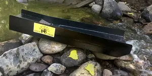

ImageUploadedByTreasureNet.com1502584684.258610.webptested out the GGT Nugget today. It seems to run good with a lot of flow but still need to classify, I did 1/2" and fed it with a small hand trowel. This is a good size if you want to hike a long ways and want to do some small scale sampling. I think I'm going to fabricate a mount for my UTV and mount it on there for creek crossings [emoji106]. All in all it's a decent little sluice but I think I'll be buying the Mother load when the rush is over
Hard to tell in a bird's eye view, but it appears the sluice is nearly completely submerged???
I had about 1/2 inch sticking out by there were a few spots where the water was spilling over
Next time out take a few photos from side angles too - helps to see the setup. Depending on the gravel size you are feeding and flow velocity, you may be able to slowly feed the Nugget with your shovel. We will be developing a setup and use video just on the Nugget in about a week... Will post here on TNet and let you know when it posts. Glad you are enjoying the Nugget!
View attachment 1482512tested out the GGT Nugget today. It seems to run good with a lot of flow but still need to classify, I did 1/2" and fed it with a small hand trowel. This is a good size if you want to hike a long ways and want to do some small scale sampling. I think I'm going to fabricate a mount for my UTV and mount it on there for creek crossings [emoji106]. All in all it's a decent little sluice but I think I'll be buying the Mother load when the rush is over
Just my opinion here, but in terms of efficiency and production, I suspect you would come out ahead by forgetting about the classifying. Sure, you're always going to have to pick out the baseball-sized and above by hand...and occasionally use your hands/shovel to clear 1"+ stuff that gets hung up on the grizzlies. That said, I am confident that the amount of time and effort you spend to do that will pale in comparison to the time and effort you'll spend filling your screen one shovel at a time, setting your shovel to the side, bending over the bucket, shaking it, emptying out the +1/2", grabbing your shovel again, repeating til you have a full bucket and finally feeding the sluice one hand trowel at a time.
You'll get in to a lot better rhythm with your digging if you're not starting and stopping so much...and ultimately move a lot more gold-bearing material through your box if you don't interrupt the process to classify. Again, I admit that the Grizzly isn't a perfect solution...but for me it was about embracing the lesser of the evils - in this case, the amount of time and work you'll put into manually clearing the grizzlies (even if its after ever shovel-full) is going to be less than what you expend in the process of classifying each shovel-full . At the very least, if you insist on classifying, you should go ahead and use your digging shovel to feed the classified material out of the bucket about 5x faster than you can with a little trowel. If you aren't able to get the box to clear an entire shovel-full of sub 1/2" material, you most likely need to tune your setup. Tough to tell from the angle in your photo, but it looks like you might be running it a little flat...increasing the pitch should help move material down the deck and past the grizzlies.
I speak from experience. When I first got a fluid bed sluice, I classified to 1" - after some trial-and-error and a sore back I decided that occasionally using my long-handled shovel to move larger rocks down the deck was a walk in the park by comparison.
Just my opinion here, but ...I suspect you would come out ahead by forgetting about the classifying.
I will always remember a day in Massachusetts with KevinInColorado (yes, despite his name he prospects in other states too) where he had his BGT and I had a traditional sluice where classifying was a necessity. He and I worked similar spots in the creek, but I was classifying and he was just shoveling. He walked away with 2X the gold that day. Maybe it was because he moved more material...
I walked away from that experience feeling like I needed to eventually acquire a fluid bed sluice. I haven't ordered a Grizzly Gold Trap yet - I've been spending my prospecting time using my dredge in New Hampshire and Virginia - but I expect that I'll pick one up at some point to be used in those states/places where dredges aren't allowed.
- Brian
I have a BGT prospector and never classify I am well aware of how these things can run ....that being said, this thing is tiny and I had it a a pretty decent angle and about as much water as I could get flowing through it and it still would not clear 1/2" material if I fed it fast with a hand trowel, it is so short and narrow that the material isn't gaining must velocity before the grizzlies
