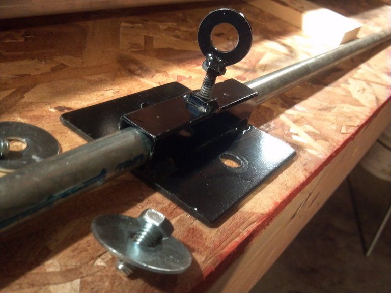

I started work on another project in anticipation of the upcoming trip.

Check out the legs and attachment method from Terrible_one's post, cool!
