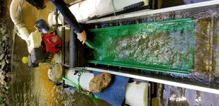

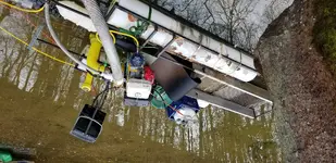

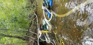

Yep, i built my 5 inch dredges frame from 1 inch square tubing. It works great. I made it so that i can run a single engine or duel engine set up. IMG_1018.webpIMG_1020.webpIMG_1021.webpIMG_1022.webpIMG_20170426_184234482.webp20181202_124133.webp20180922_123957.webp20180903_141339.webp
Sorry im not sure why the pictures are flipped around weird, they were all right side up in my folders.
Nice setup! I'm using the same type and number of barrels for my floats.
N-Lionberger - You could get away with using 4 15 gallon drums for a 4 inch dredge setup. Mine is a 5 inch with 20inch wide by 60inch sluice box and 8 hp motor, and even when running it still has plenty of flotation. Depends on if you want excess flotation or if you want light weight.

Got itchy so I went to my friends ranch in northern Nevada to take it for a spin. I used my Vortxrex booster jet which worked well had good suction. The propane power works great. The hot water heater felt like I was constantly peeing my suit all over LOL. My new full face mask with army gas mask glasses works great, the flare header I fab'd from ABS works great on levels I hadn't even conceived, I assumed it would increase fine recovery but didn't realize to the extent it would increase suction and diminish plugups. The only issue I encountered was I set up the sluice too low in the frame causing back pressure which clogged my undercurrent.
