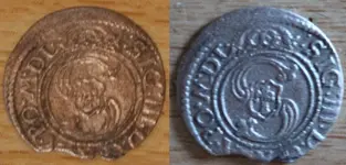

I have purchased these Hungarian coins of ebay. Some of them are silver but when i was cleaning them i realised that they have changed more of a orange copper color.
I have like 5 of the same coins that are silver-copper alloy and they're not all silver colored apart from 1. I have had some outstanding results with vinegar with a coin that looked like
nothing turned to a coin with lots of details.

I'm sure a lot of folks would agree with me when I say use nothing more than soapy water & a soft brush. If you really cherish these coins, then I would not attempt in cleaning them anymore than this. If you are willing to take the risk and possibly ruin the coins, there are several cleaning methods out there but none are going to make your coins look new. I wouldn't chance it!
I don't think that these Hungarian denars are very high grade silver, and I think that often the alloy was improperly mixed. Those coins with higher grade silver are likely to be much better looking, while those with more copper have likely corroded. It looks like your coins on the left have a lot more copper in them than the one on the right, thus it looks "better". Since most of these hammered coins are dug coins, the silver won't be affected by the ground moisture as much as the base metal ones.
Sometimes these lower-grade silver coins have been plated with silver so that they look better and look like higher-grade silver and so those with full silvering will look better than a coin which had its plating worn or flecked off. Although I'm not sure if these coins were, there seems to be a lot for sale, but comparatively very little information on them.

This, on the other hand is a Henry VIII testoon (shilling) made out of debased (about 1/3 silver, 2/3 copper) and even though its nearly 400 years younger than the Edward I above, it is in worse condition because the elements attack copper more readily than they do silver, so the coin is partially porous and has a worse colour.
Clean them with Acetone! Never use vinegar, especially on old Medieval Silver coins as it can pit them and since most contain some amounts of copper, it can bring the Copper color to the surface of the coin.

Henry V111 coinage was one of the poorest in English coinage, hence the reason he was dubbed old copper nose, because his nose would turn green because of the copper cores in his coins. The coins in the post are all probably billon, and unless they have a good silver coating, it would be best leaving them be.

I found a way to make them look silver again. I did a experiment at school today with potassium persulfate. In a couple of seconds it was silver again.
I will post some pictures later
