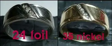

Deep Seeker...a few more things about gold.
A picture is worth about a thousand words and I have posted these pics of most of the gold I have found over the years to illustrate how gold can come in and behave and many hunters have said it helped them to understand this stuff better.
The numbers you see are from Fishers, here is a legend to compare to better common targets.
Foil on Fishers range from about 16 to 27...some have found small gold even lower into the very low 20's but I have found a few starting at 24 which is where condiment packages hit also.
This includes that small 14k heart ring and a pretty big channel wedding ring with diamonds that was white gold.
Nickels on my Fishers range from about 28-35.
Zincolns come in at the low 60's like 61-63 or so...48-52 is still zinc but very low zinc like can slaw.
White gold can be mixed with a few metals to make them that silvery color, mixed with silver they come in higher, mixed with nickel they come in lower.
The two side by side channel rings is eye opening...the 10k white gold one on the left is way bigger than the yellow 10k gold ring on the right but came in way lower at 24 vs the yellow one that was more into the nickel/tab area.
I have one or two other white gold rings that came in higher into tab/nickel but they had to be alloyed with silver...not nickel.
Notice the Neena ring...it is actually pretty small but came in very high because it is high karat 22k.
Normally a lower karat ring like this would come in way lower.
