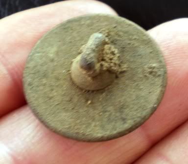

I found this one today. It is my second one this week. My instincts are telling me to leave it as is.
Yes, I would agree with you. At most, I might take a wet Q-tip and gently roll it over the surface to remove the dirt before putting it in the display case.
