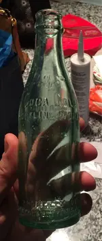

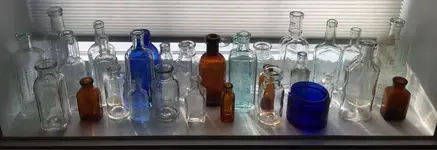

Here are a few of the bottles I have dug out of the woods. ImageUploadedByTreasureNet.com1492520450.610579.webpImageUploadedByTreasureNet.com1492520479.984729.webpImageUploadedByTreasureNet.com1492520500.475505.webpImageUploadedByTreasureNet.com1492520536.906854.webp
