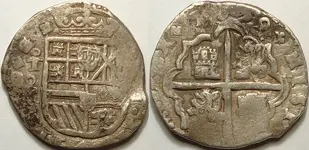

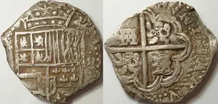

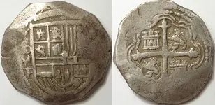

Please help Identify 8 reales?
Dear Sirs,
I'm trying to identify a coin recently given to me by my father... My guess is somewhere in the 1620's? Please see attached photos. Your help is greatly appreciated. Thank you.

Looks like a 4R from Potosi between 1649 and 1651 based on the assayer's mark of a big "O" with a dot inside; the mark of Juan Rodriquez de Roas. The denomination 4R is represented by the four 'bars' under the 'O'.
Don.......
That's not a 4 reale. It says viii if you look closely. There was a transitional period during Phillip the IV where there was some 8s that had the Arabic numeral and some with Roman numerals. Also that "O" is not the assayers initials the assayer is on the left side of the legend and it is a "T" assayer. That coin is likely from the 1620s-1630s potosi mint Phillip the IV 8 reales. The "O" was the last letter of the word Ocho meaning 8.
