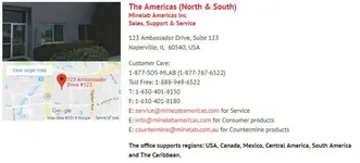

NO problem on sending into Minelab, My friend Keith runs the Factory repair center and will give very fast service. Just call the service number and they will set you up..
The machine will go to PA. The detector center where they will call you and give you a estimate..then all will go from there..most are out the door a few days later.
