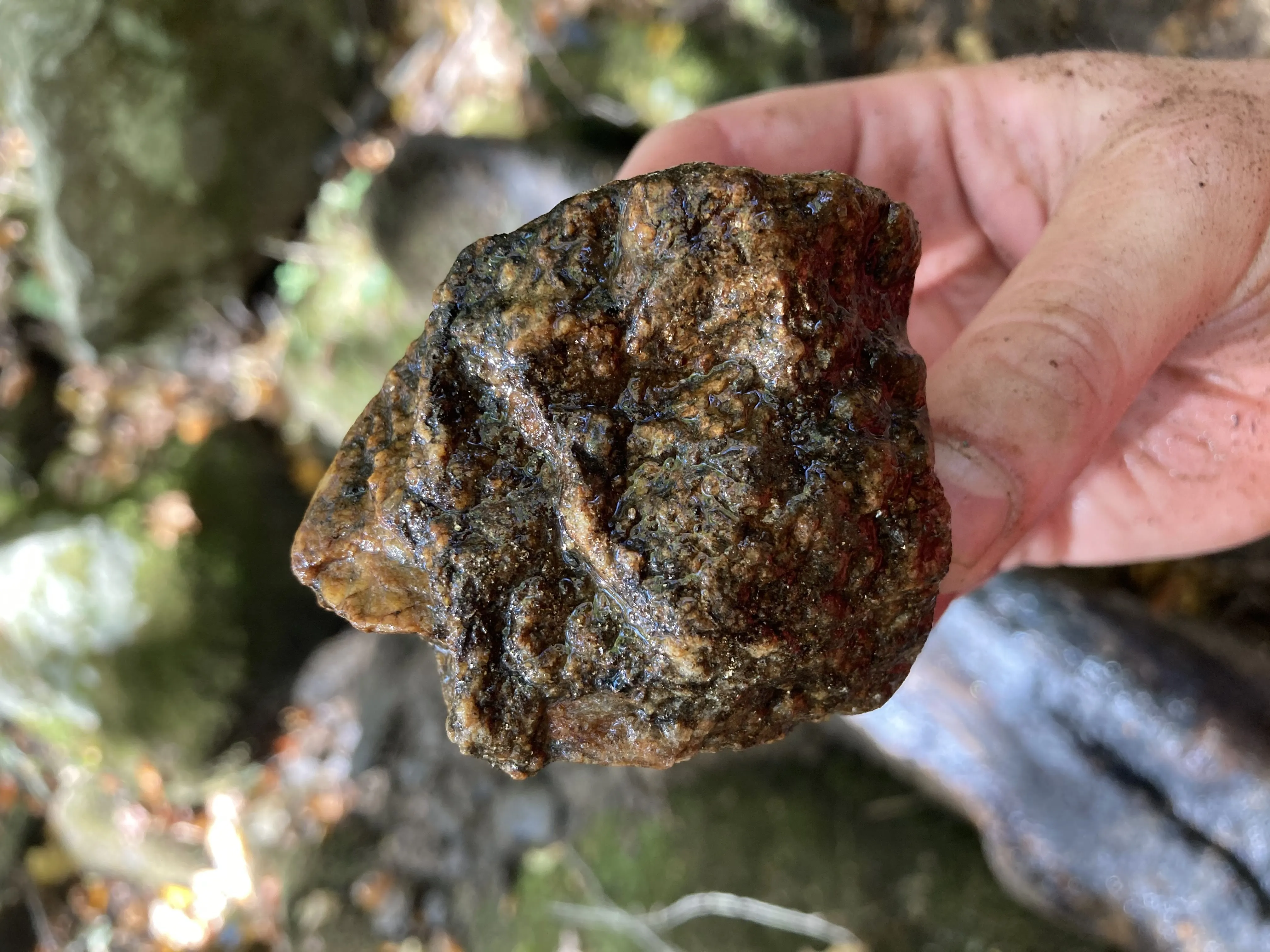

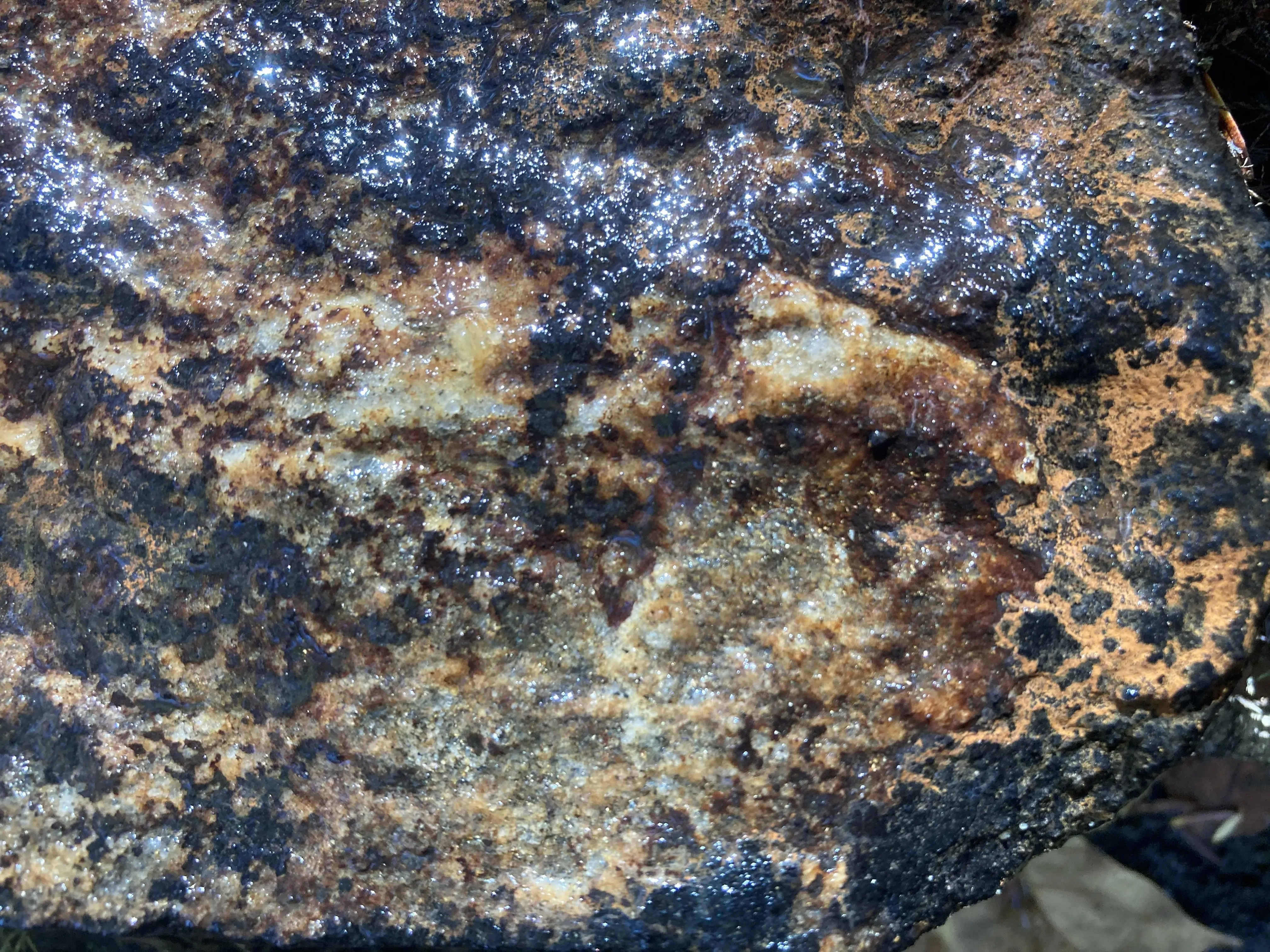

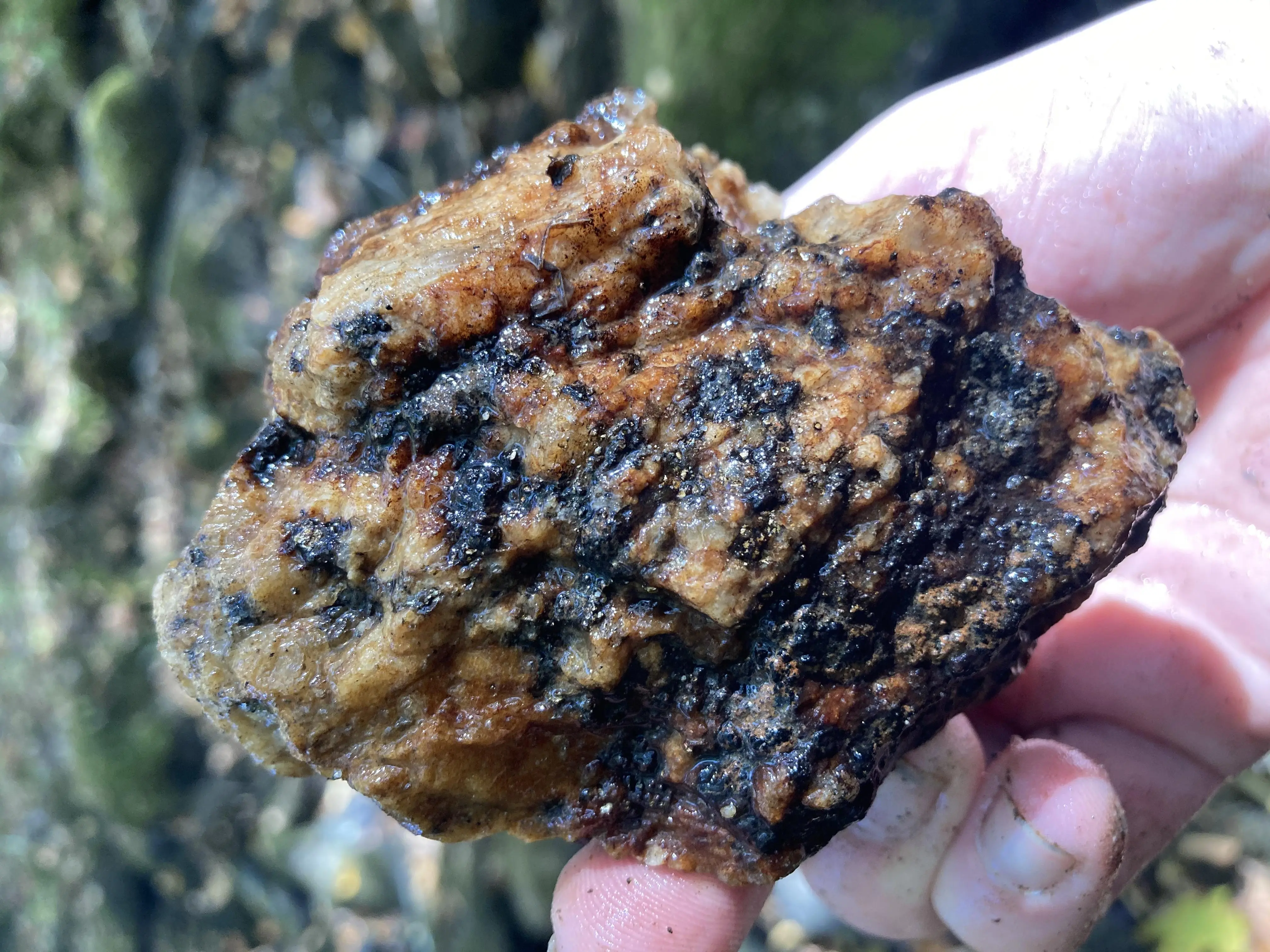

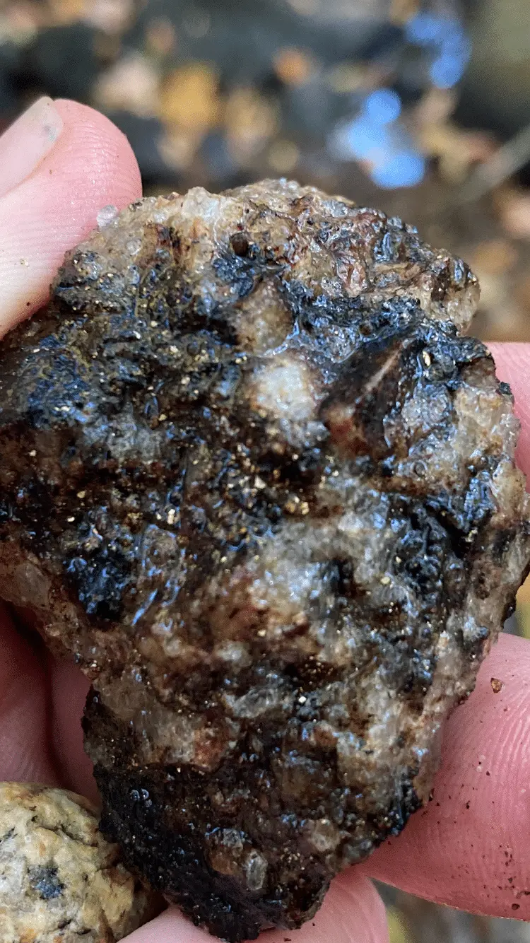

Went and did a little digging in an old river and found some interesting looking rocks with what looks like Quartz and Pyrite. Anyone know what I may be looking at? There were some good chest sized rocks with the same makeup as well.
Any info or ideas are greatly appreciated!
Citrine Quartz with newer volcanic lava-rock?
Crush and pan that will give you the answer you need, could be some in there.
Dunno where your prospecting in ct but ive heard that the housatonic river has had a history of gold bein found. As well as a few small creeks. Farmington river mid- far noth has small amounts of gold in it. Just takes alot of material to find anything significant from what ive heard, or gathered.. still plenty of left out there to be found tho! Id be interested in what this ore is composed of tho fersure. Has some nice color in it. Cheers
An iron mortar an pestle should be in every prospectors kit, crush and pan it out.
And the Mortar & Pestle are so EZ to make ! Use Black iron for the parts of at-least a 3 X 4 inch pipe nipple and a black iron pipe cap ! I used (EZ quick build) threaded fitting's BUT the weld together parts are also good ! Plus I've made them of a bigger diameter and longer (out of heavier steel ) also with a steel rod several feet long for a small rock crusher to bust up the larger piece's ! Good Luck on your process !:icon_thumright:
I had similar questions when getting started. In short you can't tell from a photo or just by looking unless you have really rich visible gold. You need to crush it really fine and pan it or get it assayed to know if your ore has gold in it.

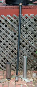

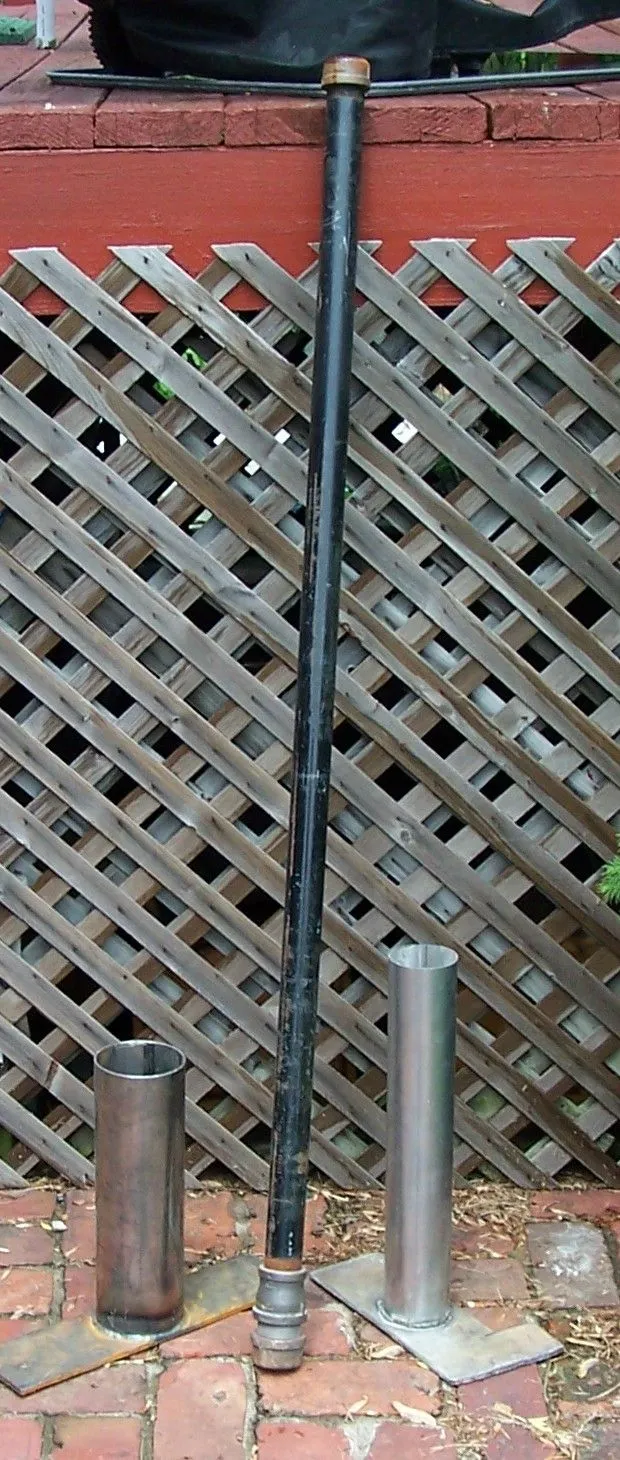

Here is a portable sampling crusher that I made from 2" pipe for the ramrod and 3" and 4" exhaust tubing and 1/4" steel plate for the bottoms of the chambers.
The ramrod pipe has a one inch by three foot long rebar inside which adds weight and creates a double impact ......
