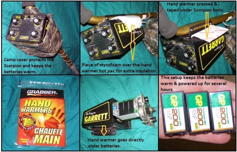

As I drove to work in the darkness this morning, it snowed. Yikes.....but no problem. I headed straight home after work, got out one of those hand warmer hot pacs, taped it on the Scorp underneath where the batteries are situated, put on the camo cover and I was ready to go. I hit a soccer field and low and behold, the Scorp found another ring. And it was just at the freezing point outside. This setup worked well, as expected.

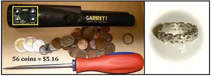

Pic of the finds is below. :)

Nice post as most don't know that batteries need to be warm to work properly and supply the correct voltage. I like the pic of the probe with the red handle. Newbies think they only need an electronic one. I sometimes probe with a bayonet because it jams in the middle of the pull tab or ring for "popping" it out of the ground.

You are so right Sandman. I have been winter hunting for over 10 years, and both NiMH and rechargeable alkalines need a warmer temperature to operate. If I run either type at -5C/23F without keeping them warm with a hotpack, they are dead in about an hour. With a hot pac, they last about 6 hours. The NiMH fair better then the rechargeable alkalines, and an interesting note is that the NiMH don't retain a higher voltage when brought up to normal room temperatures, however the rechargeable alkaline do. The TID screens on the Garretts slow down in reaction time as they get colder, however, the audio response time remains the same. I believe the coldest temp which I have hunted in was about -25C/-13F. The only problem I had was that the headphone wires become very stiff, and I had concerns about them maybe cracking at the 1/4 inch headphone jack or the headset end.
