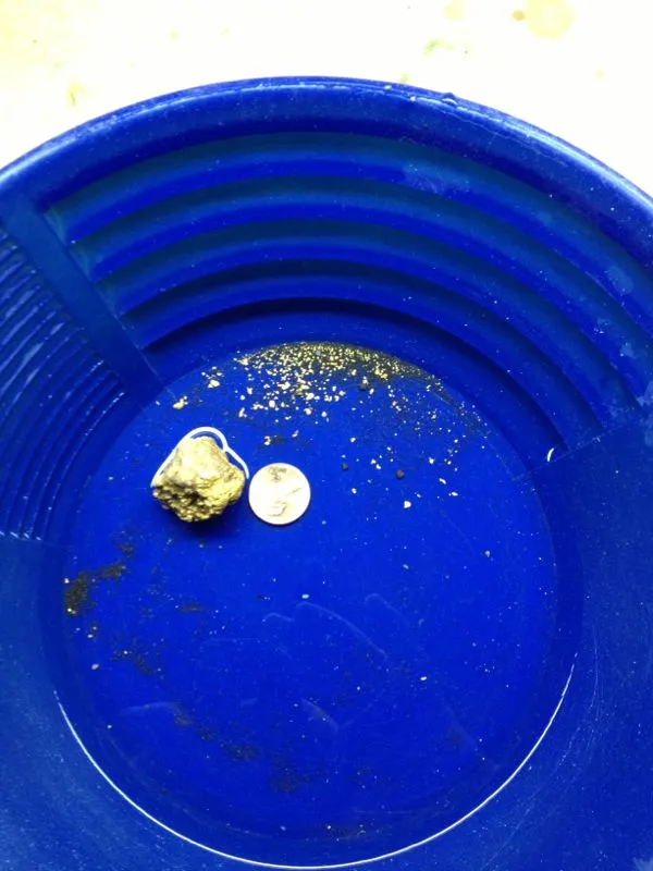

Finding that 1.3 oz nugget last month sure helped my brain, so gonna go back soon to find its bigger brother. Sorry had to gloat some more! :) :) Hope all is well you FP.
