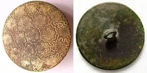

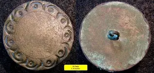

Attached some of my big buttons, they usually but not always have some type of design on them, usually hard to see unless cleaned of all dirt buildup. the 1.44 inch button is most likely not from the late 1700s, but not sure.
