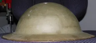

I just recently aquired a WW1 american helmet with the heat stamping under the brim indicating "UC 308". Any chance that this was an american manufacturer? I know 'Z' is the most common because I have a few of those, but I read somewhere that the letters "X" and "Y" was also used. I find no info at all on "U". Was briefly listed on another blog that it was american also. If so, is it rare? I know the "X" is quite rare. I have seen "Y" on occasions. As for "ZA, ZC, ZD and ZJ', those are quite dominate. So can the letter "U" be more rare than the "X"? I'll include pics. Thanks.
B105FA as to rarity of the helmet that I can't answer, there is no list that shows the heat stamping linked to a specific manufacturer, but the UC marking is an American marking. Another way to tell is by the shape of the rivets, on American ones they are normally domed on both sides. Post a few pictures of your helmet, the US used them up to the early part of WWII so, looking at the liner one can tell if it's a WWI or WWII configured helmet.
The problem with the US ones there is no printed list that shows all the markings/stamps. I have one posted on this site, and continue to add to it. So I guess I need to update my list.

There are a slew of other countries that used the Brodie style helmet. This link has some of them listed with the markings that can be found in them. Figured with that site and my ever expanding list it would give some helmet collectors a good stepping off point to use in identifying their helmets.
Brodie Manufacturers - The Brodie Helmet and its derivatives
Thanks Mike. There is a problem with the fact that the helmet is missing both the liner and straps but the rivets are not split but domed copper like. I heard that "U" is rare as well as "X" for american helmets and just wanted to make sure. I have a number of "Z" helmets also. British helmets I do not collect because those appear to be a dime a dozen. Again, thanks.
I've heard the same thing B105FA about the rarity but can not find any definitive data to substantiate that claim. I wish there was more information available on the internet on the M1917 and M1917A helmets. What little information I've learned and collected has come from reading site upon site, trying to fill in the blanks in my data.

Here is what is suppose to be "UC308" marking. I know it's a lousy pic but that's the closest I can get. Again, you have been quite of great help. Now to look out for that "X" marked helmet. Hmmm, "ZF and ZH". Those I have not seen either.
If you come across any helmets with markings other than the ones I have listed would you be so kind as to foward the information to me?
Sure thing, I will. I was on E-Bay earlier and found a couple helmets with "ZB" stamped on the brim. I guess you can add that also to american manufacturers.
