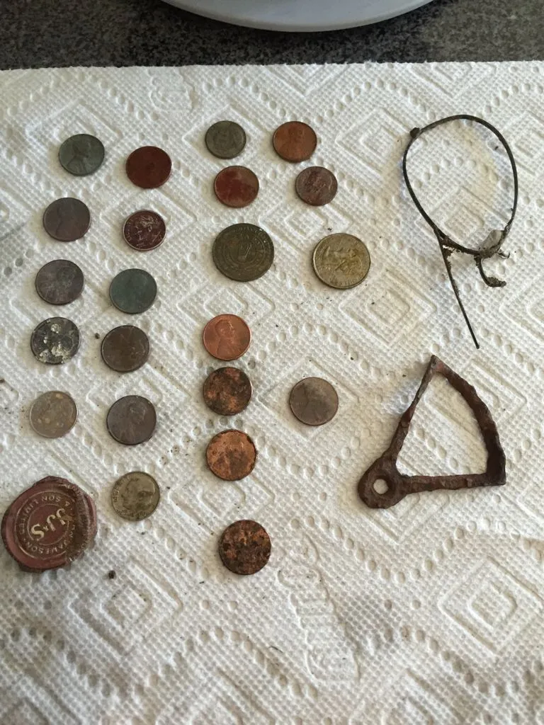

Yesterday went out with the ATP trying out new setting using Iron Audio and pulled up clad along with a 1954 Dime!!!! Woohoo!
