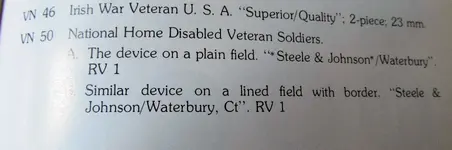

Nice find! :icon_thumleft: This button is in Albert in the "Veteran's Organizations" section VN 50 for the National Home Disabled Veteran Soldiers -

I think the book has it wrong?
Vaughan Garrett's January 2014 Winners

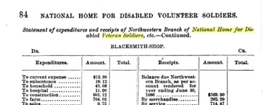

''National Home for Disabled Volunteer Soldiers''
Interesting! I just searched for both phrases and "National Home for Disabled Volunteer Soldiers" definitely has more hits and I think that is probably more accurate - though "National Home for Disabled Veteran Soldiers" does come up too - even in the official documents.
(attached is a scan of a page from the Report of the Board of Managers c. 1880s)
