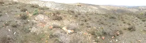

Another series of quartz rocks I came accross. One thing I noticed, in slate host rock,there are more quartz indices at altitude below 6000 ft, than there are above that.
Here are some outcrops photos,
And
This sample is not quartz, but it is sedimentary rock, again heavily mineralized, host rock is serpantine and ophiolite.
And this is the vein sample came from, it is 1 foot wide and 30 feet long and visible,
