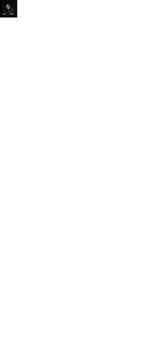

hi Mike i was just wondering if by chance there was
any way you could put indicator marks around the
Threshold pot & GB pot simular too this photo shure
would look nicer & more Professional
I sold that unit to some guy in Russia last year. I use Troy's Shadow X5, Shadow X2, and a Minelab Musketeer now. He seemed very happy with it.
