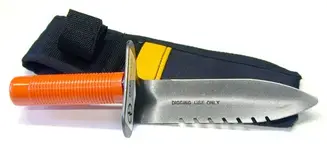

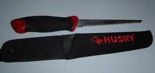

Ricardo, I've found the Lesche digger to be the best (for me and I'm sure others). I've used mine for 10 years. I'm somewhat of a speed digger with it. I'm a righty but use it in my left hand because my detector is always velcroed to my right arm. Rarely do I take out my right arm unless it's one of those tough plugs to cut. Look into it,you might like it. After awhile I put a new edge on the blade side and use a small round file to redo the serrated side. I don't use it for cutting roots anymore. I got a small jab saw from home depot for $10. Works great.
