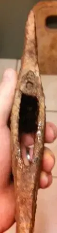

Hi everyone! This is my first hatchet, and the handle is the first thing that I ever carved before, so please go easy on me. I have a ton of room for improvement!
Anyway earlier in the spring I was at my grandparent's 1840s or earlier property in Southern Ohio. I dug up this old axehead and knew right away I wanted to restore it somehow, but shelved it for the time being. I have no use for an axe, so I decided to modify it and make a hatchet out of it!
Today at work (during breaks) my goal was to get the head prepped to make into a hatchet. I started by sandblasting it with metal sand to get off all the rust. I might have used electrolysis but I ruined my battery charger and don't have a replacement at the moment. After sandblasting, I picked a spot to cut the head so that I can begin converting it to a hatchet. After cutting it, I made a small piece of cold roll steel to cap the open end off, leaving extra to grind flush. I welded it to the existing steel.
After I welded it and let it cool, I used the extra stock from the butt to grind it flush and smooth out the surface a bit. I decided against grinding enough to completely smooth it because I wanted the hatchet to keep a bit of it's history. I didn't want it to lose it's story, so to speak. I only have a woodcutting machete and a folding knife to work with but I'll make do!
Cutting the handle is part where I struggle a bit. Carving wood is something I'm completely new at, but I gave it my best shot!
After fastening the head to the new handle, I was able to split a small stack of wood for a fire with it!

Great work! You have skills :)
good job by you!..and the cows watching you dig still kills me:laughing7:
Thanks guys I appreciate the kind words. I posted it elsewhere and got trashed by everyone because I cut an old axehead, but the way I see it, I don't sell any of my finds, and it was just sitting with a multitude of other relics that I've dug, so I figured why not make it into something I WILL use?

Almost cried seeing the axe in the bandsaw.... Then saw what you did with it. Great idea! Great job! Hows it balance?

It seems pretty well balanced so far. Cuts really nice :)
I'll be making a new handle once I get better skills lol
Today I worked on the handle and made it much nicer :)
