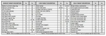

Here's one chart I've run into - pretty close by experience:
