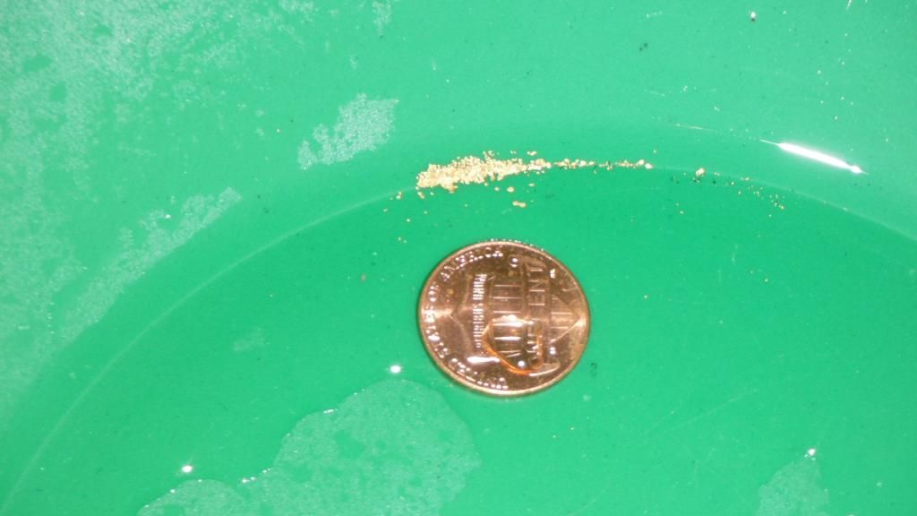

Took out my 30' prospector for the first time today! Really impressed..... I got 3x-5x times what i normally get with my AM. Granted Im a newbie so neither were probably running optimally. Well anyways I found a spot to set up the BGT. Water over the top was much slower then I expected. I probably should have found a deeper spot but i figured what the hell, let me test it this way first. I had to help the rocks over the grizzly's by hand and the overall feed was slow because of this. So i didnt know what to expect after my cleanup. I only really ran 4-5 5g buckets worth. I put a bucket at the end and lifted it up and to my surprise there is a GIANT rock stuck in the bottom intake.....I cant for the life of me figure out how this rock got sucked up in there because it was a large rock......it was definitely impeding water flow to the pipes and probably affect my fluid bed and gold recovery...idk.. but that being said I LOVED this thing!!! So much easier not having to classify! I might have lost some gold but it for sure catches the fine flour gold really well. So that is not an issue. You cant go wrong with this thing. Its hands down better then a regular sluice! Not even a contest....IMO.... If I correct the mistakes I made I think I will do 5x times my usual production easily. You cant argue with that!!!!!

Would you say your increased production is due to better capture, moving more material or ??
I would say both...I used it again today. Not only does it catch the finest of flour gold, but you can not shovel fast enough....this thing is a hungry beast!! catches the powder, moves more material without classifying then you can dig,1-step- 1time cleanup per day and its just more fun! Dumping in large rocks is so much more fun! Its like a little wash plant! you can actually wash those big rocks easily with out fear of dumping gold! I was quite impressed with my tailings pile today :) #happygoldminer
great to hear of your positive experience. That's just how I feel about it in fact! Quite an amazing tool overall.

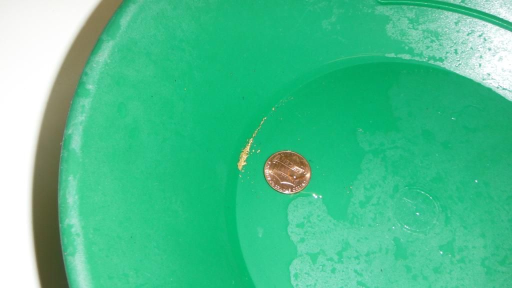

Ran a few buckets with the mini today. Cool cause it fits in my backpack but you need to classify, yuk! Lol...i did notice that the trap didnt seem to be filling all the way up like the prospector did, not sure why. Maybe to steep of angle?
yes, most likely. Even when run dead flat the amount is modest so at an angle...not so good.

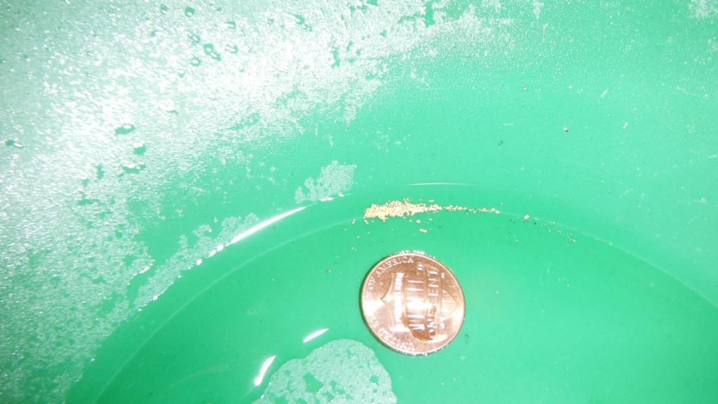

I also made my first attempt at crevicing today! Used my flathead screwdriver and hammer to break apart a few cracks of bedrock and i actually got some decent stuff. A few larger flakes then what i was getting the other day. All in all i would say slightly more today in half the time, plus larger pieces going after the bedrock...i was surprised at how easy it came apart ! All in all i think the work is easier working the bedrock then shovel buckets but maybe that because the area im using has soooooo much rock, makes the digging tuff...idk....just a newbie out here on the river all by his lonesome and loving every minute of it!!!!!!
Well, it seems like you are sorting out what techniques work best for your conditions. Great to hear you are getting some results crevicing. I know Red (owner of goldnsand) ties the one gallon bucket to his belt just like you describe. He is reluctant to recommend that due to concerns about safety...you are essentially tying a weight to yourself in a stream or river...one step closer to drowning.
Next spring when I get back on the creek with Red I will have to ask him about this situation of getting very little material to see if he has more hints. I haven't been using mine lately due to the easy shoveling in the creek i am working. The bedrock is a decaying sandstone I can scrape up with a shovel so I know I'm getting that last, gold rich, bit!
You wont get so much material filling the mini's trap as you do with the larger units..... It's a good thing. :icon_thumleft:
Means it is more efficient at clearing out the lighter material due in part to the traps smaller dimensions. (less backpressure on the fluidizing tubes) Remember it's the gold you want not a bunch of gravels.
Run it as flat as possible though, same with all sizes.

mytimetoshine,
Which one of your bgt's do you like better? Any particular reason you opted for the 30 inch prospector over the 36 inch prospector? Looks like some of the colors you found were smaller than -50s, is that correct? I will be getting a bgt in the spring and am trying to decide which one to buy. I just got a gold n sand for xmas, seems you aren't to impressed with yours? Thanks for any info offered.
mytimetoshine,
Well i was conflicted about which one to get but i opted for the 30 because it was a little cheaper and lighter weight and the way it sounded was that I wouldnt be able to shovel fast enough anyway...and I was right. Wouldnt have been any advantage to having the 36 since i prospect by myself, maybe with a partner or some really easy digging you may need more sluice...yes they are fly poop tiny tiny pieces :( but at least we know the BGT will catch the smallest of gold!! Yea not to impressed with the gold and sand...I really thought it was going to work well....maybe it would work better with the bucket lower then the extraction site but I dont see how this is possible. The darn water is at the lowest point already , so how are you supposed to position your bucket lower??? idk...havent completely given up on it yet but I dont think i will be using it until I figure out what is wrong..
