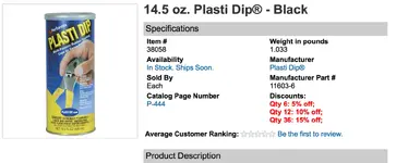

My Garrett Carrot tip wore through and now it's giving false readings, sometimes stays with a constant beep on even when near nothing. Is it common for these things to wear out? I've had it less than a year and the tip is pretty much gone. I don't dig with it, it's just sanded off. Can you coat them with something? I doubt if it's waterproof anymore because it was doing weird stuff from just getting the dew from grass on the tip.

This should work.

If you wore a hole in the tip of your carrot, thats on you, not a design problem. Apparently you are scrubbing that thing a lot more than you think you are. When you get a new one, yes you can use a plastic dip to provide a little more protection, but it sounds like you are going to wear through that quickly if you don't change how you use it.
