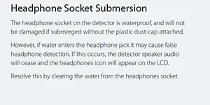

I've heard that but I don't know if I believe it. Is that written in the manual? I keep the plug in mine until I get waterproof phones.
doesnt matter one bit. The audio plug receiver is waterproof on its own.
Here is the page from the manual. From what it says I would not believe the socket is waterproof unless something is screwed in. Screenshot_20191101-183101_Adobe%20Acrobat.webp
ROFL "electrocuted?" Priceless. Needed that.
Trust me, this was all hashed out when it was first released. The designed phones have an o-ring to keep grit and saltwater out. You are supposed to use a waterproof phone connector in UW situations to keep saltwater from corroding the socket. The manual even states that if you get saltwater in the headphone socket to dry it out to prevent corrosion.

I do know if you dont use the Nox water proof connector for headphones and just plug in a standard 3.5mm headphone jack it will leak under water pressure. I even added an extra o'ring on mine, one is stock internal and one I added fits around the external side of the HP jack so mine is protected by 2 o-rings.
Water will leak into the jack but not into the housing electronics as there is another o-ring behind the jack. You just need to dry out the jack as stated in the user manual section I clipped above if your headphone detection circuit is activated by the conductivity of any residual water in the jack but no circuit damage should occur and you will want to do that to prevent any long term corrosion of the metallic jack contacts by salt water. Therefore, you are still covered by warranty even if you submerge the Equinox with nothing covering the jack (no dust plug or headphone needs to be plugged in) per the user manual excerpt as long as you dry it out. Using the appropriate connector with a set of waterproof headphones will prevent this of course, but it more of an annoyance vs. detrimental to the detector if you do submerge it with a standard plug or no plug at all. Just dry it out.
That's if the other o-ring is there and seated properly. I want run mine with out waterproof headphones if I'm in salt water.
Agree with you, I wouldn't actually run mine that way either because you are relying on that last o ring and who wants to hassle with making sure the connector is rinsed of salt water and dried out after submerged use, so it makes sense to add the extra protective robustness of a properly designed headphone connector. All I was trying to point out is that ML DESIGNED the detector to be able to be submerged with nothing plugged into that recessed headphone jack including that flimsy plastic screw-in dust cover. Since you've repaired your fair share Excals and other water rigs, I trust your judgment on where you are willing to roll the dice as far as watertight designs are concerned, especially on your own detector.I
