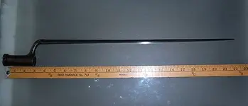

Hello All,
Here's something fascinating I'd like to get information on if possible.
In the 1930's my father used to visit a junk yard in New Orleans and search for things that little boys like: muskets, swords, WW I helmets, and other war related items.
He purchased 4 Civil War era muskets and swords for mere quarters and cleaned them up to bring them back to life. One item was always referred to as a French bayonet. (Pictured) It is 22" long and three sided. There is no 'blood gutter" on the blade. The hole in which the base of the bayonet is attached to the muzzle of the rifle is 15/16" in diameter. I can't quite understand how it is attached to the rifle but it appears to twist on the barrel. On the goose neck of the bayonet the numbers "543" can be found. There is a small circular indentation at the top of the goose neck where it connects to the blade.
My 85 year old, WW II disabled Vet, father lost everything in his home during Katrina however he had a few treasures in his attic. This was one of them.
Can anyone give me information on this bayonet? My guess is that it is from the Franco Prussian war and made its way to the US for the Civil War. Any ideas?
Thanks for any help.
Jon

The Franco Prussian War was 5 years after the U.S. Civil War was over. This bayonet could be from anywhere from the late 1700s to the 1870s. It might, at one time, have had a locking ring to secure it to the end of the barrel. There are hundreds of different triangular bayonets. You sometimes need a micrometer and a good reference book to determine whch one you have.
One photo seems to show the completely un-fluted blade is a lot wider than it is "tall." (In other words, shaped like a low-angle A-frame roof.) So, it appears to be what I was told long ago is an early-1800s Prussian (German) bayonet, from sometime in the first half of the 1800s. But I may have been given incorrect information.
Nonetheless, it seems to match this one ...a Prussian Model-1809 Postdam Musket bayonet: Bayonet for Prussian 1809 Potsdam musket, 18-1/4" hand forged blade - Track of the Wolf
The 15/16ths-inch hole for the barrel indicates it is for a .69-to-.72-caliber musket. Note that there is no slot in it for allowing it to fit past a muzzle-sight.

That's it! It's a Potsdam musket bayonet. Thank you all for your help as I will save this information when I pass it down.
