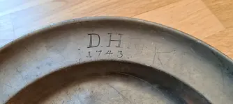

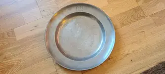

I came across a pewter bowl. At least, I believe it is pewter.
I belonged to my father, but it says "1743" on the front (as far as I can tell). If that is the year of production or birth/marriage/confirmation of "D.H.", it is obviously much older than my father.
I've searched Norwegian, Swedish and British publications on hallmarks, but I am not able to find out what country, what time period or which producer this comes from. I am, ultimately, also trying to find out who "D.H." was.
If anyone can help med shed some light on this or point me to useful directoreis, it would be greatly appreciated.

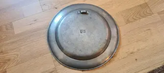

The wear all around the bottom tells me that the hanger was added much later?

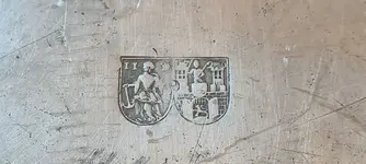

I'm guessing it is English pewter. The left touch-mark represents Hope. The II is the initials of the pewterer and is likely JJ as the letter J was typically represented with an I back then.
Yes, quite possibly. It is likely to someone, at some point, saw this as more of an ornamental piece, rather than something for everyday use.

Great! Thank you. Already, I'm "armed" with a lot more information to use in my search.

I can’t track down the marks but given the second shield has 1720 at the top I would think this likely represents the date of manufacture. Fits with the 1743 engraving too.
The first shield does indeed have "Hope" personified with an anchor, although that doesn't necessarily make it English. I couldn't find the mark either, but they're more difficult to trace than silver marks... especially if it's not an English mark.
The '1720' date across the towers of what I think are the gates to a city wall isn't likely to be the date of manufacture. More likely the establishment date of the maker, or the entry of his mark into a register.

First... the date on the topside is NOT the date of this plate... but the more probable the date the hanger was added.

My expert contact at the Pewter Society agrees that it’s a typical 18th Century plain rimmed plate from Eastern Continental Europe with contemporary owner’s initials engraved on it. The mark to the right is “most likely” for Prague, but could be for Bohemia in general (Prague was the historic capital of Bohemia, which included part of what is now Germany).
The standard reference for Bohemian pewter is Friedrich Tischer’s book “Bohmisches Zinn Seine Marken” (first published in 1928 and republished in 1973) but neither mark is listed. My contact also kindly checked all seven volumes of Erwin Hintze’s reference books on German pewter in case it’s from a maker in what is now Germany, but again couldn’t find a match.
The maker’s initials appear to be “IID”, not just “II”, but with a separation between the “II” and the “D” (and the “II” part would be interchangeable with “JJ” in modern letters). So, sadly, it appears to be an undocumented maker, of which there are still many.
