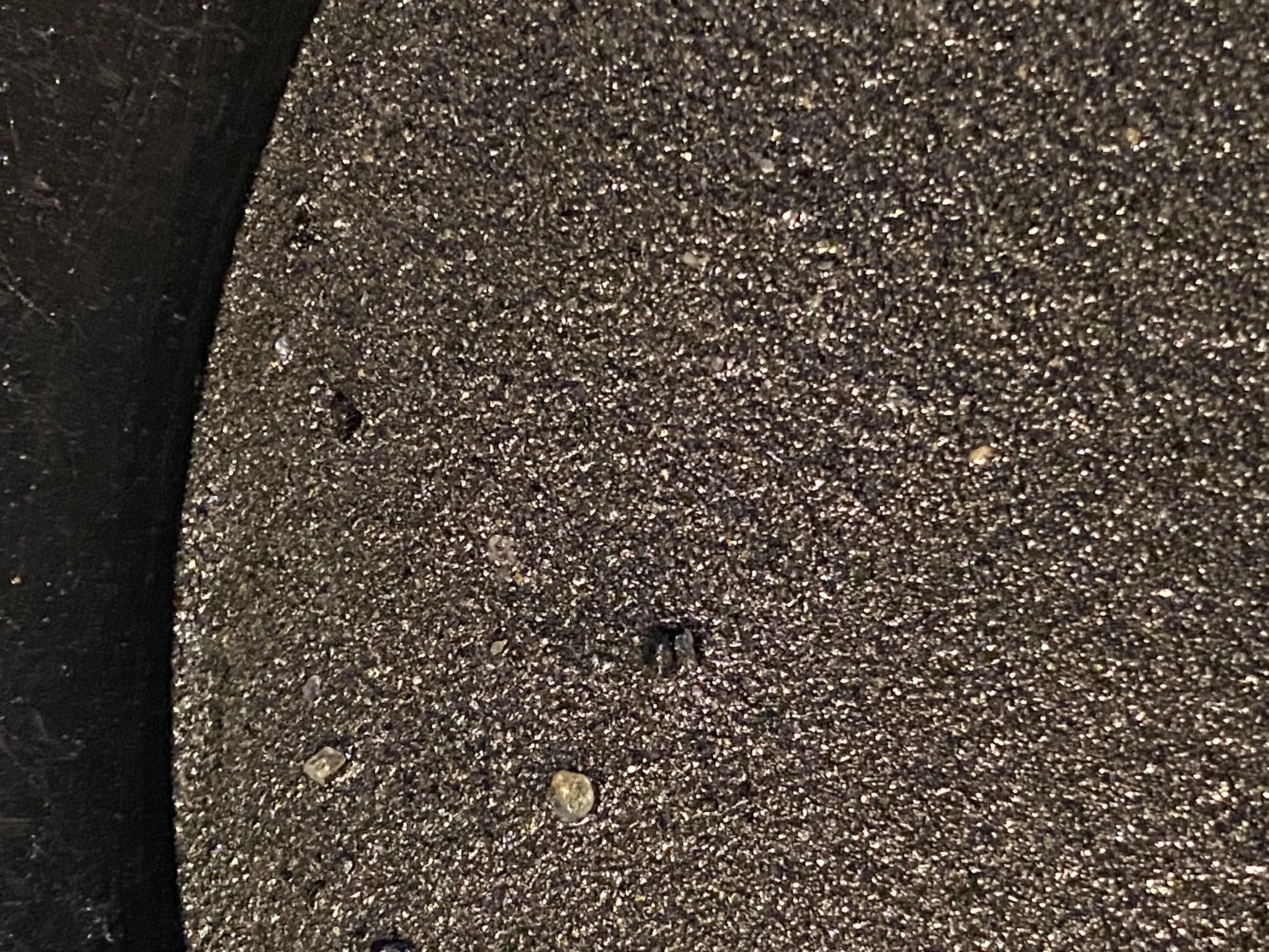

I went digging today. Area had an even higher concentration of silver. See pic below.

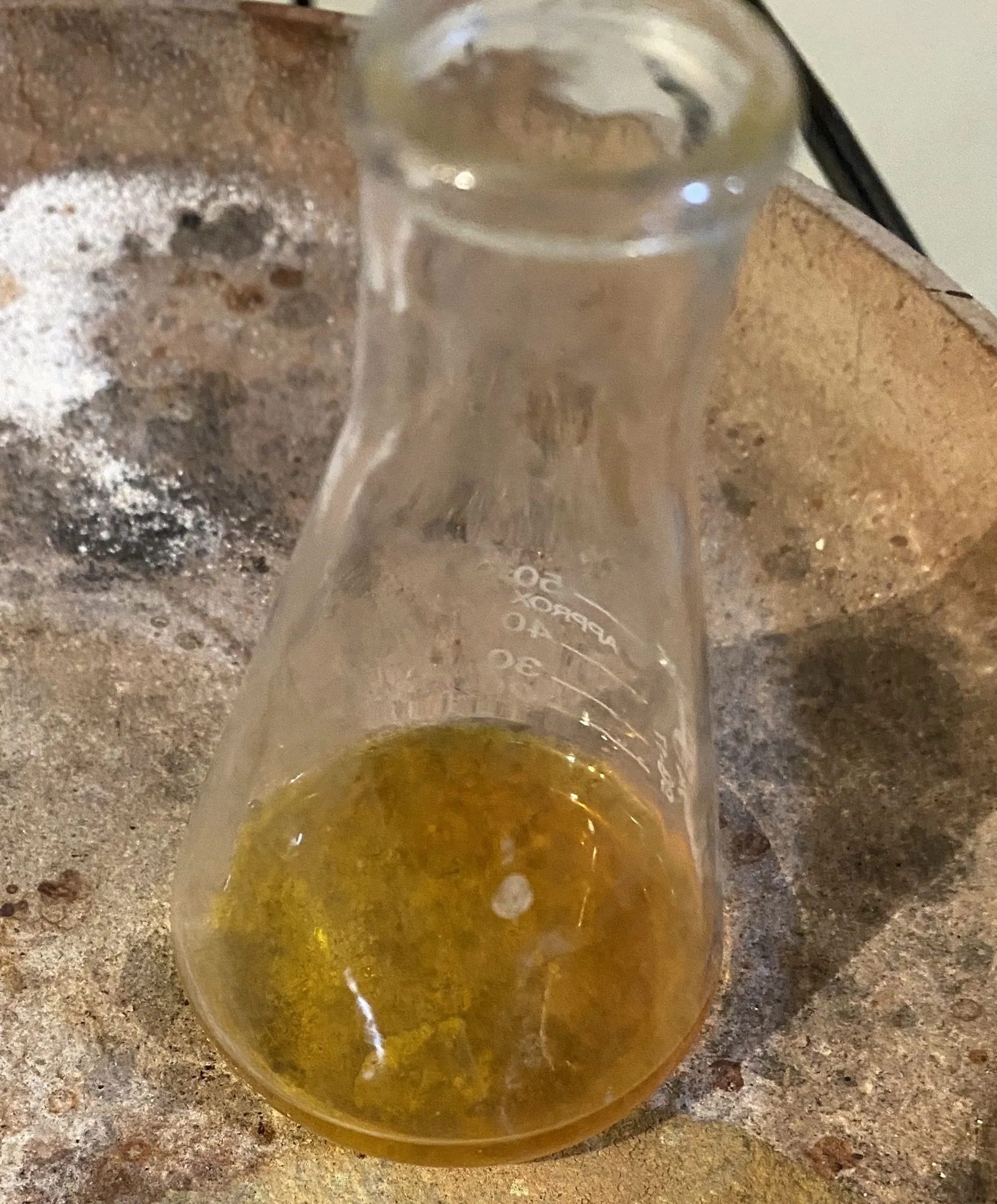

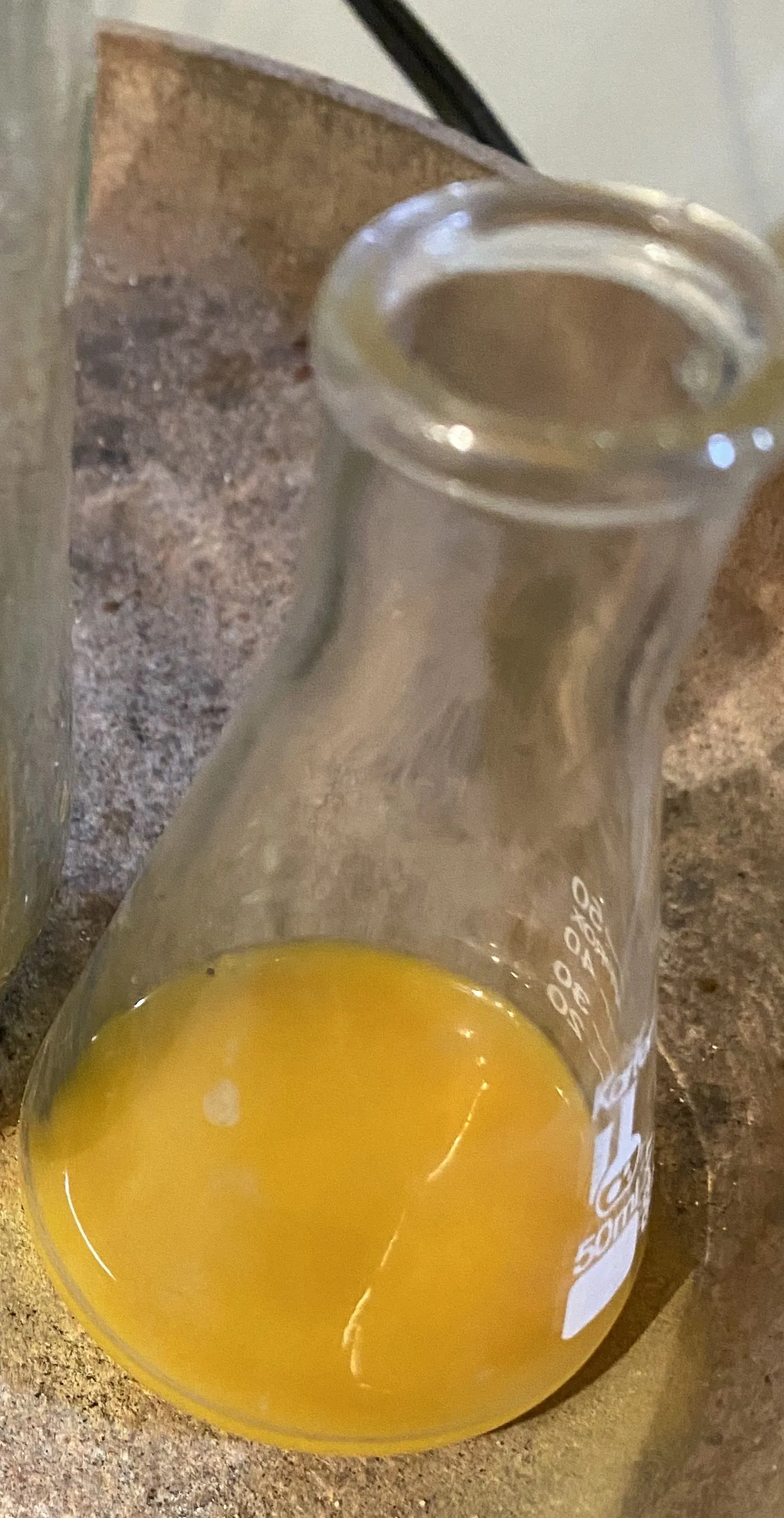

Put a small amount of material in aqua regia (didn’t know it was silver at this point). Had to add nitric twice. First pic below is result in beaker. Took it off heat and let it cool. Tested with stannous chloride. Test sample immediately went milky white. Dead give away for silver. Second pic is aqua regia after putting it back on heat and then adding HCL. This precipitated silver chloride from solution.
I know what you’re thinking ... silver isn’t dissolved in aqua regia. Right? It would if all the HCL was consumed while still having a good amount of nitric. Then, nitric dissolved silver.
