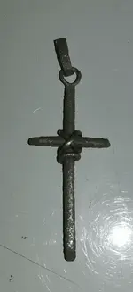

Found small cross already started baking soda aluminum foil. Gonna take long time
white vinegar and salt. Cover it with vinegar add about teaspoon of salt ,mix well. some things take a few mins. some thing take longer. If you use it for coins, don't put copper with clad. It will turn everything copper color.
Yeah it's not a coin so if there's no crust to be removed it's just a matter of cleaning off tarnish.

Here's how I do it. As Gator said, if it's not crusty then I'll usually skip the electrolysis, if it is crusty then I'll use the electrolysis just to help remove the crusty stuff. Once I'm down to just the tarnish then I use Tarnex, applying it with a small but fairly stiff artist brush, letting it soak for just a few seconds before washing it off - first with a well soaped up wet rag, then a quick rinse in running freshwater and then dry with a soft rag/towel. I'll repeat this process as many times as it takes. I do well over a hundred pieces a year, some worse then others, and this always works well for me. Chains are usually the hardest - "most time consuming", that and those really crusty rings with settings where the crust and tarnish is behind the setting or deep in the cracks and scroll work, this is where the stiff bristled artist brush comes into play.

First off thanks for the help. This after 10 times of 2 minute dips. I
With tarnX sorry about lack of info. This looks like its old. Any suggestions? I bet u guys are hunting right now. Damit Jim
Tarn X is not going to hurt silver you could put it in acid and it would be fine... Yeah at the beach now

Can you see any marking on the back or on the clasp? sterling , or 925?

Thanks Lorraine gonna let it sit longer in the tarnX get more pics soon
