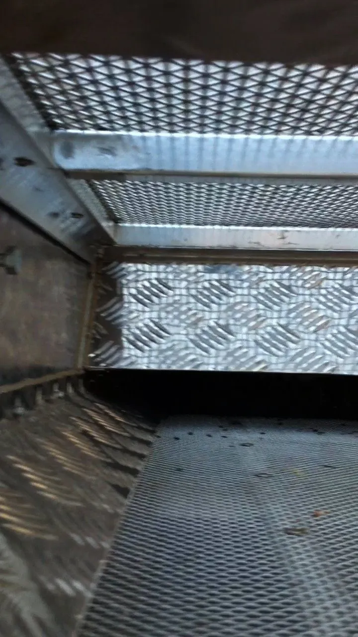

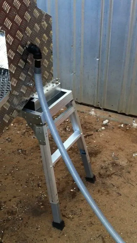

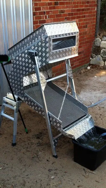

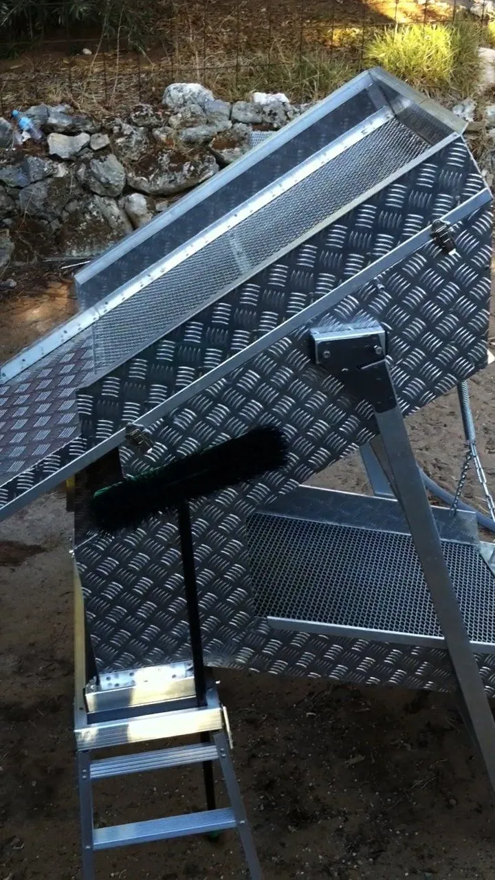

This aluminium and stainless machine collects the gold fines 98% in the miners mat under the ali grid.
It sorts the shovelled dirt into lumps at back, medium sizing (max detectable size) in a bucked underneath, and fines run through the sluice.
Water needed to run 40 ltrs and uses 20 ltrs water in evaporation per day.
Basically if we carry 5x20 ltr containers in the cruiser we can stay bush for 6 days
Small 2 stroke runs beautifully starts every time and stays on idle.
This can be used with damp dirt and the unit can be disassembled easily and carried by one person.
Designed to do 3 ton + plus per hour.
Easily keeps up with two guys on the shovel
The two separate piles lumps and medium size materials are detected as you go along.
Easy operation and solid built.

One point the desert sluice is basically designed for the hot dry summers and where soils are usually very dry
Ie an alternative to the dryblower
It screens the shovel intake dry and that falls to a pile at back
The material then falls to the second screen still dry and the + 2.5 approximate falls dry to a trough under the machine
These first two dry piles are detected as they grow

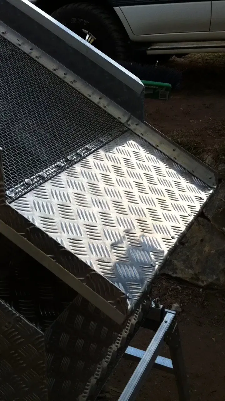

The -2.5 dry material then falls to the internal hopper and is fed to the top/ back of the final screen/ sluice it is sprayed( found it just needs a gentle regular flow) and the fines easily work their way down the sluice grill with the miners mat underneath
If there is a build up the water vol are increased an the hard bristle Broom is used to work the fines up or down
The desert sluice was made to recover the fine gold only and as such the fines are usually the far smaller
portion of a shovel load
In wa have approximate 65% of a shovel load is fines silica and magnetite/ iron oxide
So in this case we find the clowdy water settles quickly, and when we work limestone areas and decomposed calcretes Ther are far less fines
Water usage really is good naturally with care
One could use three troughs if need be, to rotate if the 55 liter black trough is filling up to fast
We have found it doesn't need this and it would need more water in the circuit
This machine is easy and a gem to use and this choice of pump was spot on
