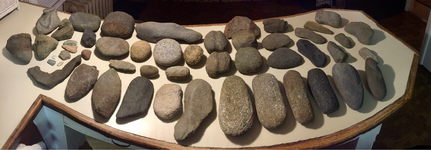

The fishing weights I know are definite artifacts, proving that I can be certain of this location, but I have many questionable/unidentifiable finds. Unfortunately I cannot post individual photos of everything like I wanted to, due to forum limits, so I’ve only posted some. These items were all found on the shoreline- and have been exposed to salt and tide for many years- with the exception of the (possible) hide scraper. If there are any questions I can try my best to provide better pictures of individual items. Please let me know what you think, and if you can identify anything for me! Thank you!!

A bit overwhelming when so many rocks are posted to one thread. I've been hunting in southern New England for roughly 60 years, and I can help you narrow down what is artifactual among your finds.
In your very first photo, the bottom two rocks are known as full groove weights. The Handbook of Native American Artifacts from Southern New England, published by the Massachusetts Archaeological Society(MAS) dates these as Early Archaic through Late Woodland, so they enjoyed usage for a very long time. The rock in the upper left of that photo does appear to be a basic Notched Weight, dated Early through Late Woodland. They are often just barely notched, and I'm judging that's what you have there. The rock in upper right appears natural to my eyes:
Next are two bifacially worked pieces. Because one is argillite, actually argelaceous slate, I am guessing you are hunting in southern New England. Those two lithics, quartz and argillite, are the two most common lithics in southern New England. They look damaged, though the argillite piece may be just what you think it is. Hard to know for certain without examining in hand, but they are clearly artifactual:
Lastly, this may be a quartzite or rhyolite, and there may be a worked edge on the bottom. I can't tell from the photo, and this is only a maybe. It is significantly broken if an artifact, or it could be a large flake with a worked knife edge. Would need to examine:
All the remaining rocks appear natural to my eyes. I might change my mind if I examined some of them, but right now I only see natural. Your best finds are the two grooved weights. They are not common finds.
