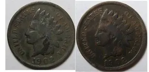

Here's a before/after shot of an IHC conserved with VERDI-CARE™.

Hey, that's pretty cool V-C. I'll remember that for the future. Welcome to T-Net. :hello:
As far as the one in question, I would leave it as is. Looks good with all that green. :thumbsup:
