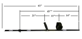

easy I am about the same height I have a Anderson carbon fiber shaft that makes it almost weightless the upper shaft is 45" long, behind the arm cuff is 14" the lower shaft is the same length as the original shaft. It seems long at first but like I said it's almost weightless even after several hours swing it. Carbon fiber or an aluminum rod has about the same effect it's the leveraged design that works well. Hope that helps.
