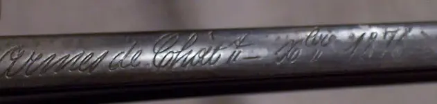

the dates on this sword go from 1848 to 1878 its all in french, could yall translate this for me and give me an idea of what it is worth?
If it has the owners name on it i was thinking i could try to look up the history on it, i also wanted to find out if it was a civil war sword. thanks

pippinwhitepaws said:
Franco-Prussian war.

during the napoleon era, the french began engraving battles, honors,., ect on their blades, to honor the veterans of the battles...over time those swords and bayonets ended up in other hands, and the market...
basic officer issue, decent condition can bring from 250. up...
they are not the most popular of swords, though i do like the steel used in some of those blades, turns nice an black.
a pic showing the entire blade and scabbard would help identification. cav, infantry, artillery, naval?

Ink, if you found this we are definitely hunting THAT area again!!!

u can see the blade now, its duble edge. im goin to have to get it out of my safe and try to put what it says on the blade.
Don't try to transcribe what it says on the whole blade, just post a series of photos for goodness sake. One after another, left to right down the length of the blade. C'mon.

Smithbrown said:
It probably says something along the lines of Manufacteur des Armes de Chât(elleraul)t (French month- possible Nvbre ) and date -either 1871 or 1876- cannot see exactly.
Châtellerault was one of the main sources of French swords http://en.wikipedia.org/wiki/Châtellerault
