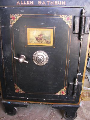

How was the bottum fassend.
Re: Old Yale safe - ideas on age & how to open
Looked like it was factory welded. Interesting in the construction though.
The sides are form bent and at the bottom welded. the back was bent and formed into a lip that fit a groove bent in the sides at the back (which would have made getting a pry bar impossible). The interior wall was also fit the same as the outside. The concrete mix had a chicken wire and series of 1/6 rods throughout for strength and support.
After all was done he had a local scrap iron dealer pickup the safe.

since we brought it back up, I've gone through the bottom of 2 class B safes, taking the back of the doors off to get the combo.
The 2 I did had the wheels welded to a frame/plate that was bolted to the bottom. I unbolted it, exposing the insulation, removed that, cut a hole in the sheet metal floor, and that was it.
One had a small safe inside the big one, and some rolls of pennies had fallen in behind it. I thought I hit the jackpot when rolled coins started spilling out, but it didn't amount to much.
Once I got the combos by taking the back of the doors off, I bolted the wheel-plate back on, and poured a concrete floor in the bottom.

Q, what is stopping someone from popping the pin, on the hinges of these safes
http://0.tqn.com/w/experts/Locksmithing-3110/2008/09/SafeFront.jpg
http://www.antiquesnavigator.com/ebay/images/2011/380335182561.jpg
http://0.tqn.com/w/experts/Antique-Safes-3774/2010/04/Safe_92.jpg
Most all safes both old and new have what we call a dead bar or bolts that, when you close the door, protrude into the hinge side jamb of the safe, effectively locking the door into the body of the safe. So, you can completely cut the hinges off a safe and the door still won't open. I tell my customers: If you could just cut the hinges off and get in it wouldn't be a safe would it??? :-)
