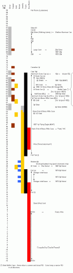

Here's a shortcut to what coins fall where on the scale.
Advice most appreciated....great chart. I have heard that the designer of the whites dfx designed the F75, any truth to this?
