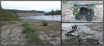

Yesterday, I headed out of Edmonton to a favorite gold digging spot along the north Saskatchewan River. Here's my location and rig, nicely packed up on a wagon, and set up.

with that much sluice run .. if its classifying to 1/2 or less.
Try running with a little less grade
At least if your pump has decent volume.
if you can get the water faster you can always set your sluice flatter.
try it
I like your trolley for the water pump. Nice idea.

I am running a 1" pump this year, so I need to add a bit more grade, otherwise, my riffles plug up to much. My losses are at an acceptable level form my few checks which I have done.
I might switch to 1 1/2" pump next year. I am classifying my gravel to 3/8"
yea, that's not enough water for a sluice that big.. But you gotta do what you can.
